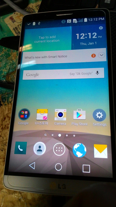

GOODAF MGA KA ANTTECH SHARE KO LANG GAWA KO LG G3 ON/OFF PO PROBLEMA

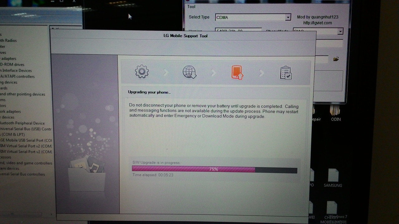

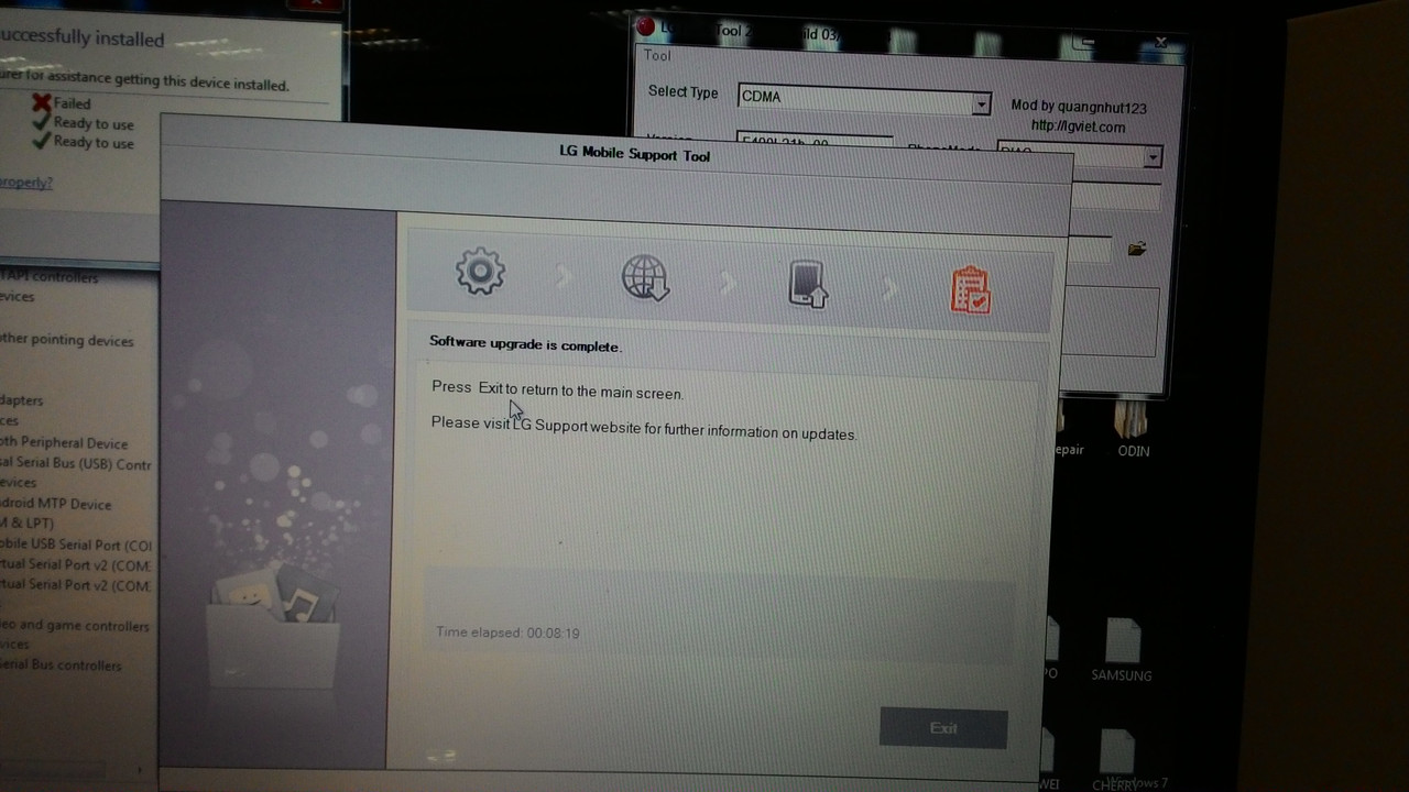

TRY KO PALIT BATTERY GANUN PARIN.KAYA GINAWA KO FLASHING NA AGAD AT YUN AY SUCCESSFUL NMAN.
PROCCEDURE
OPEN LG-FLASH-TOOL-2014

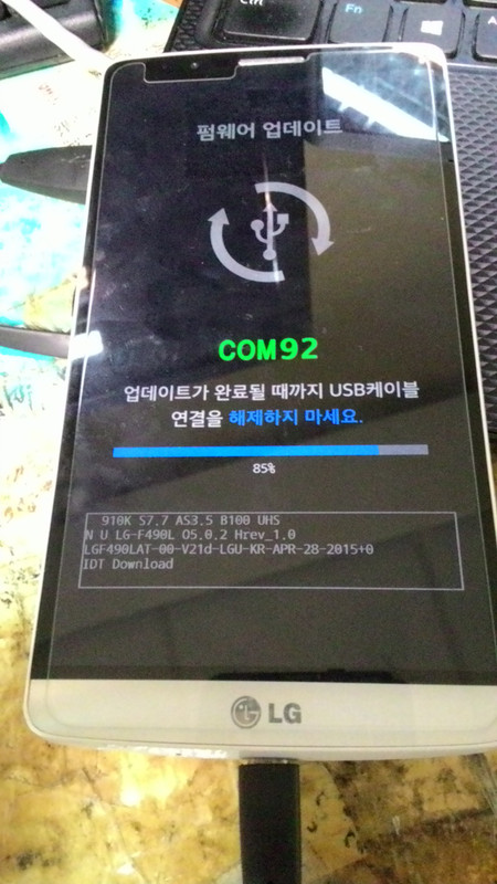

HOLD VOLUME UP+ PRA SA DOWNLOAD MODE
INSERT USB
FIRMWARE DL...
https://lg-firmwares.com/downloads-file/651/F490L21b_00.kdz
FLASHING DONE..~H KAPE NAH...
SANA MAKATULONG SA TAHANAN...
