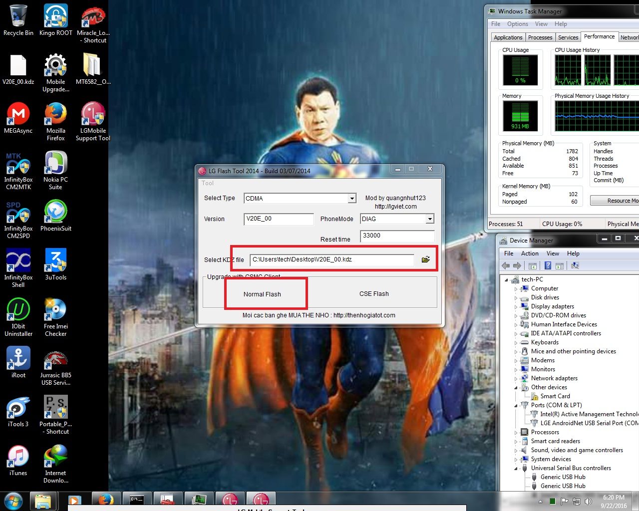

This Stock is KDZ file, remember to copy this KDZ file into LG Flash Tool 2014 folder
Check the firmware that match with your phone version,

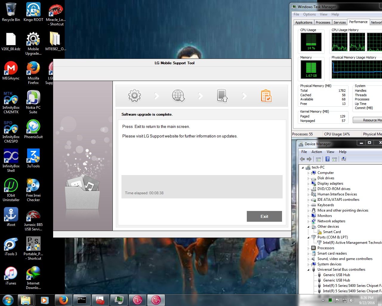

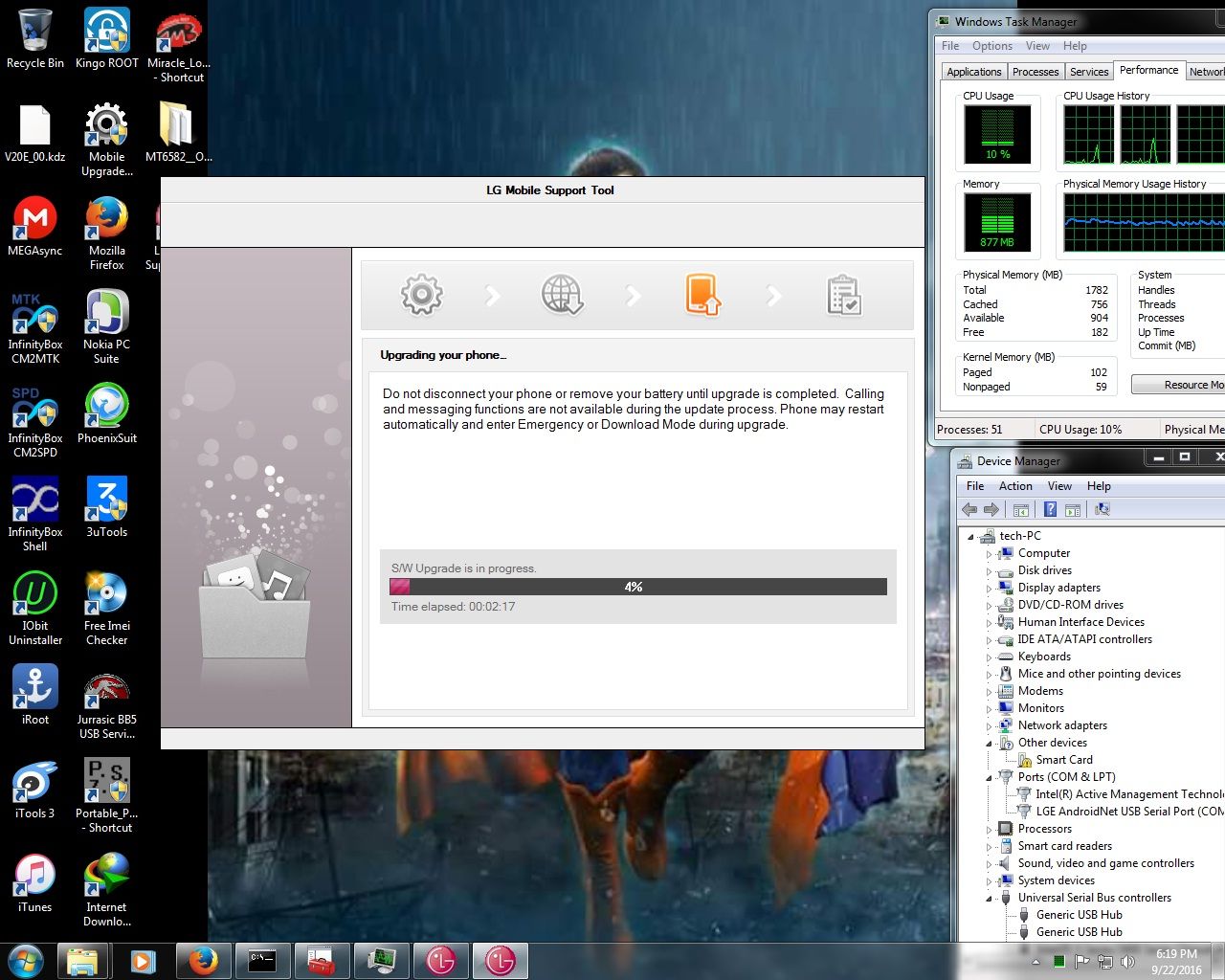

PROCEDURE : Una patay ang unit at open ang flashtool ni LG tpos Press UP VOLUME para makapasok sa DOWNLOAD MODE ung phone then click Flashtool load flashfile then click normal flash at wait lng my lalabas jan Click start and wait until flashing done sundan nio nlang po ung mga printscreen ko sana hindi kau malito HAHAHAHAHA =)) ...
Quote:
KONG NAGUGULUHAN TALAGA KAYO SUNDAN NIYO NALANG YUNG PINAGSUNDAN KO HAHAHAHA =))
