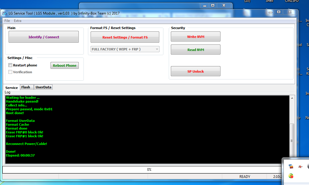

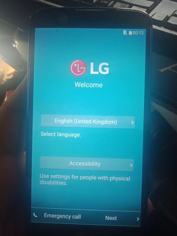

LG K10 (K430n) frp done via cm2
open cm2 LGS module click format fs..
install drivers if needed
follow software instructions
https://i.postimg.cc/FsJbXCpc/IMG20181031140713.jpg
https://i.postimg.cc/C1qDpzH0/IMG20181031140722.jpg
2. PRESS and HOLD VOLUME UP KEY!
3. Insert USB cable, wait until Download mode screen will appear
https://i.postimg.cc/FR3fnwNs/K10.png
Wait for phone...
Connection opened successfully!
Waiting for loader ...
Handshake passed!
Collect info...
Prepare passed, mode 0x01
Boot done!
Format UserData
Format Cache
Format done
Erase FRP#0 block Ok!
Erase FRP#1 block Ok!
Reconnect Power/Cable!
Done!
Elapsed: 00:00:53
