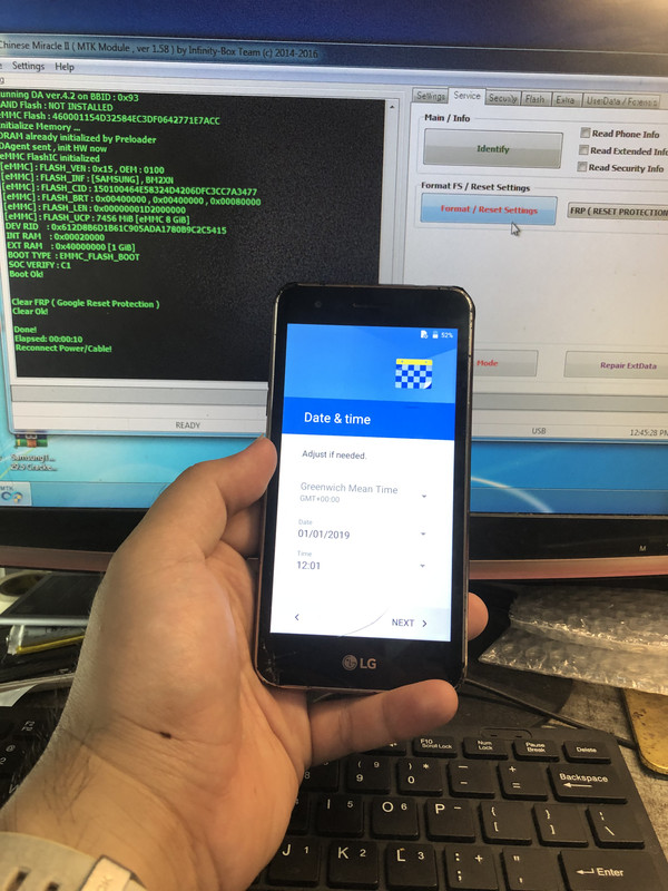

FRP problem
open CM2MTK

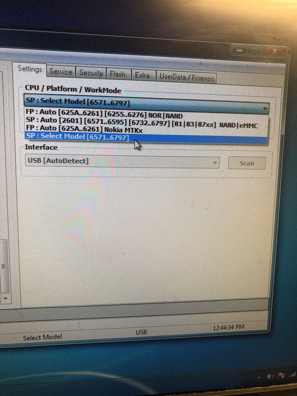

1. select model [6571..6797]

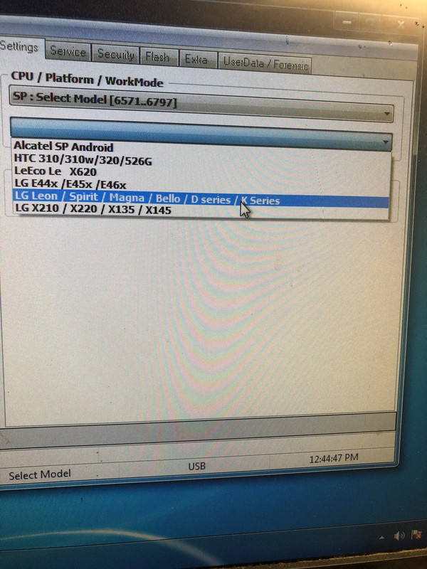

2.Click LG Leon/Spirit/Magna....etc
3.Go to service tab, choose frp (reset protection) and hit format/ reset setting off ur phone and insert usb cable no need bootkey
