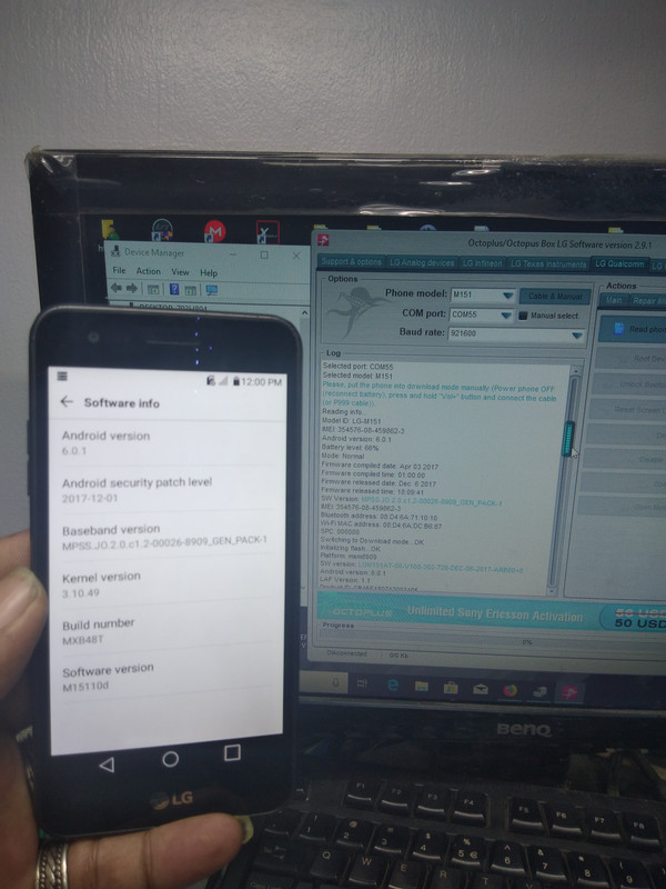

unit lg-m151
problem frp
since error sa direct reset frp sa octoplus at need flash frp unlock galing sa support ng octo...
kaya flash ko na...
logs in error direct frp resset
Checking data...OK
Platform: LG Qualcomm
Selected port: COM55
Selected model: M151
Please, put the phone into download mode manually (Power phone OFF

Resetting FRP Lock...
LAF Error: 80000121.
Trying second method...Failed!
LAF Error: 0F0F0F0F.
Please, reflash with "M150x-M160x_Android_6.0.x_for_Reset_FRP.oct"
firmware from Support Area ("LG/FOR UNLOCK AND REPAIR" folder), and
try to perform Reset FRP operation again.

proceed to flashing
Opening "M150x-M160x_Android_6.0.x_for_Reset_FRP.oct"...OK
Selecting firmware partitions...OK
Selected default partitions!
Setting options...OK
Do you want to format User Data?
Reading partitions...OK
Formating USERDATA...OK
Formating ENCRYPT...OK
Sending signature...OK
Writing 1/2...OK
Writing 2/2...OK
Formating RCT...OK
Formating MPT...OK
Finalizing...OK
Writing firmware done!
Performed by 2.9.1 Software version.
after flashing proceed to direct hit resset frp

Resetting FRP Lock...OK
Resetting FRP lock successfully completed!
If the phone hang on logo or is restarting afetr performing the operation,
please re-flash it using the same or higher version of firmware
here is the finish product
note ;
matatagpuan ang file sa octo support...sa folder na FOR UNLOCK AND REPAIR..
