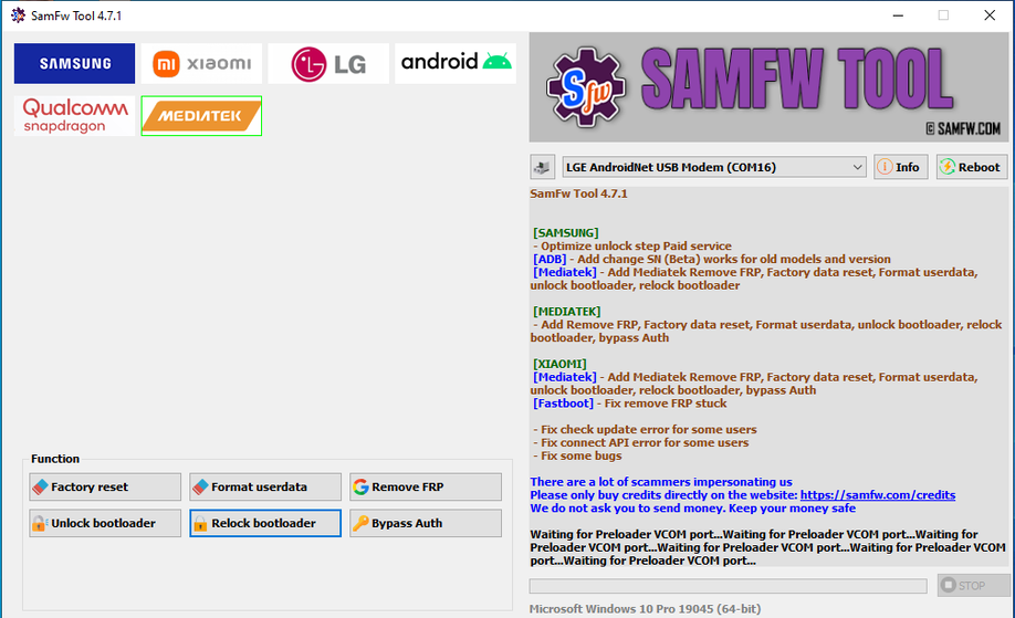

https://www.mediafire.com/file/vpsbr4y8t6jj6yf/SamFwToolSetup_v4.7.1.zip/file
USING FREE TOOLS
OPEN SAMFW TOOLS VERSION 4.7.1
SELECT MEDIATEK TAB
CLICK ERASE GOOGLE FRP
DO TEST POINT WITH BATTERY
INSERT CABLE WAIT UNTIL FINISH
ITO PO FINISH PRODUCT HINDE KO NA PICTURE NUNG NAKA FRP PA KASE KALA KO HINDE
KO TALAGA MAGAGAWA HAHA
WALA TALAGA KASE AKONG MAKITANG TEST POINT KAY GOOGLE E
YAN LANG SALAMAT MGA MASTER NEWBIE LANG PO.
