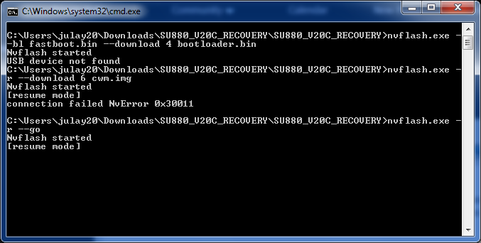

Press voll up and down connect usb
Extract Downloaded file
Open SU880_V20C_RECOVERY folder
Run flash
di ko na ss yung flash pero ito yung pic ng flasher nya
pag nag done na ok na yan
pero wag mona hogotin hangang lomabas yung sa dolo ng flashir na press any key to continue .... done na yan basta lomabas yung pag katapos ng flash mag rebot yung unit

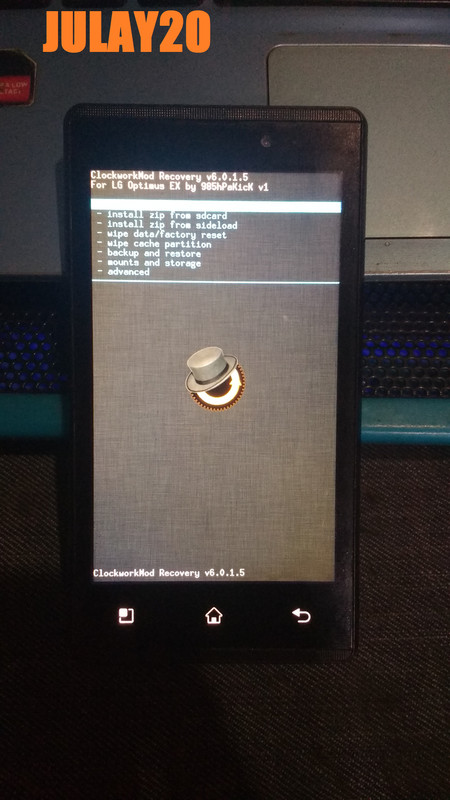

Press volume up & power switch
Release power switch when show lg logo
continue pressing volume up & wait then show recovey option
pag lomabas yan alam mona gagawin

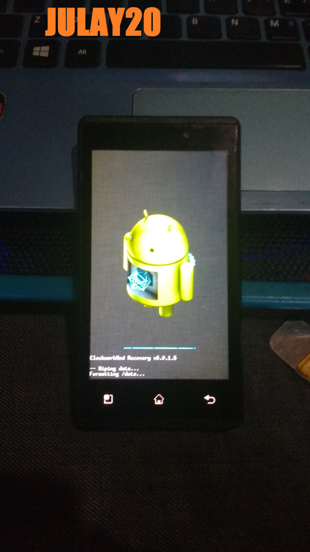

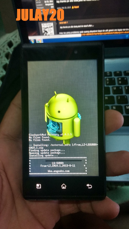

Lagay Muna natin sa SD Card yung File na LGSU880_4.2.2 version-CM10.1 system dont extract. Copy paste Lang
Then Lagay sa Phone. and Press and Hold volume up & power switch
release power switch when show lg logo
continue pressing volume up & wait then show recovey option. And Select zip file from sd card and w8 till DOne

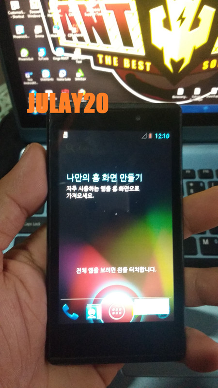

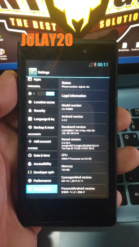

reboot mona unit ito na sya done na
