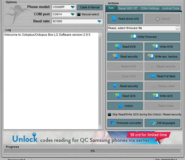

Note: To connect the phone in Normal Mode, perform following steps:
  1. Type ##7764726500 and press "Call" button;
  2. Input Service Code ("000000");
  3. Go to "W2BI - TEST SETTING" and select "W2BI SETTING ENABLE";
  4. Go to "Port check test" and select "Enable
Select Transfer Files instead of Charging Only para mag Read na ang PORT
Hit Direct Unlock and Done
For Signal Problem Credit kay @FullFlash2014 https://mega.nz/#!9NxWQRhB!KN5GtMAZRzFgqtPAAFwkwart3uesfAj5ioVVx7e9xKQ
Done
6/9/2019 11:43:19 PM > Checking data...6/9/2019 11:43:20 PM > OK
6/9/2019 11:43:20 PM > Platform: LG Qualcomm
6/9/2019 11:43:20 PM > Selected port: COM6
6/9/2019 11:43:20 PM > Selected model: VS500PP
6/9/2019 11:43:20 PM > Reading info...
6/9/2019 11:43:21 PM > Model ID: VS500PP
6/9/2019 11:43:21 PM > IMEI: 354437-08-578649-5
6/9/2019 11:43:21 PM > Android version: 6.0.1
6/9/2019 11:43:21 PM > Battery level: 61%
6/9/2019 11:43:21 PM > Mode: Normal
6/9/2019 11:43:21 PM > Firmware compiled date: Jul 06 2017
6/9/2019 11:43:21 PM > Firmware compiled time: 05:00:00
6/9/2019 11:43:21 PM > Firmware released date: Sep 14 2017
6/9/2019 11:43:21 PM > Firmware released time: 11:19:44
6/9/2019 11:43:21 PM > SW Version: 6/9/2019 11:43:21 PM > MPSS.JO.1.0.c5.7-00033-M8909EAAAANVZM-1.102965.1
6/9/2019 11:43:21 PM > SPC: 000000
6/9/2019 11:43:22 PM > MEID: 35443708578649
6/9/2019 11:43:22 PM > Mobile ESN: 808BD7B0
6/9/2019 11:43:22 PM > ReadInfoCDMA: FUnlockSSD
6/9/2019 11:43:22 PM > ReadInfoCDMA: FGetSSDA
6/9/2019 11:43:22 PM > SSD_A: 0000000000000000
6/9/2019 11:43:22 PM > ReadInfoCDMA: FGetSSDB
6/9/2019 11:43:22 PM > SSD_B: 0000000000000000
6/9/2019 11:43:22 PM > ReadInfoCDMA: FGetAKEY
6/9/2019 11:43:22 PM > NAM Name: NAM1
6/9/2019 11:43:22 PM > User Lock Code: 8368
6/9/2019 11:43:22 PM > Unlocking...
6/9/2019 11:43:23 PM > Reading QCN...
6/9/2019 11:43:23 PM > Send SPC...6/9/2019 11:43:24 PM > OK
6/9/2019 11:43:24 PM > Reading Mobile Property...6/9/2019 11:43:24 PM > OK
6/9/2019 11:43:24 PM > Reading Feature Mask...6/9/2019 11:43:24 PM > OK
6/9/2019 11:43:24 PM > Reading Roaming List 0...6/9/2019 11:43:24 PM > OK
6/9/2019 11:43:24 PM > Reading NV_Numbered Items...6/9/2019 11:44:48 PM > OK
6/9/2019 11:44:48 PM > Reading NV_Numbered SIM1 Items...6/9/2019 11:45:28 PM > OK
6/9/2019 11:45:28 PM > Reading NV_Numbered SIM2 Items...6/9/2019 11:46:49 PM > OK
6/9/2019 11:46:49 PM > Reading NV Items...6/9/2019 11:46:52 PM > OK
6/9/2019 11:46:52 PM > Reading EFS...6/9/2019 11:46:52 PM > OK
6/9/2019 11:46:52 PM > Reading Provisioning Items...6/9/2019 11:47:02 PM > OK
6/9/2019 11:47:02 PM > Reading QCN done!
6/9/2019 11:47:02 PM > Backup saved to "VS500PP_354437085786495_09-06-2019_23-43-23.qcn"
6/9/2019 11:47:02 PM > Do you want to create security backup?
6/9/2019 11:47:18 PM > Writing security area...6/9/2019 11:47:18 PM > OK
6/9/2019 11:47:18 PM > Rebooting phone...
6/9/2019 11:47:54 PM > Found model VS500PP4:ÿ® `¯ at port COM6
6/9/2019 11:47:54 PM > Phone successfully unlocked!
6/9/2019 11:47:55 PM > Rebooting phone...
6/9/2019 11:47:55 PM > Performed by 2.9.5 Software version.
6/9/2019 11:47:55 PM > Elapsed Time: 12:04:37 AM
