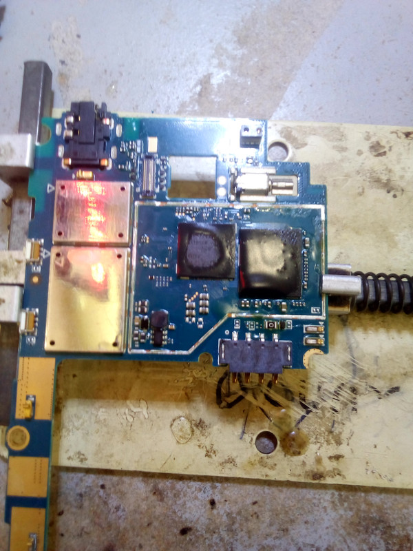

gandang araw mga boss share ko lang tanggap ko LG X155
MODEL: LG X155
PROBLEM: SPARSE DISPLAY
https://i.postimg.cc/sxHtCy1n/1.jpg
1. 1st step general cleaning no luck
2. 2nd step try lcd 2x no luck
3. third step flash using back up file from cm2 still no luck
4. last option proceed na sa hardware
https://i.postimg.cc/13XDzSXG/2.jpg
https://i.postimg.cc/9M1wtgNP/5.jpg
reheat lang po mga 10-15 secs
then palamigin ng kaunti
try power on
http://postimg.cc/q66pdv8K
done!!
