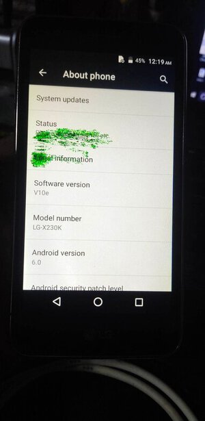

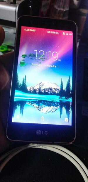

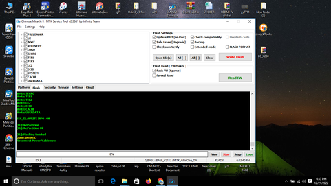

1. OPEN CM2MT2 CLICK FLASH TAPUS LOAD SCATTER FILE...... MT6737M__lge__LG-X230__mlv1__6.0__alps-mp-m0.mp1-V2.115_hq6737m.35.igb.m0 UNCHECK ALL... YUNG SYSTEM LANG E CHECK MO TAPUS CLICK WRITE FLASH HINTAYIN MATAPUS
2. LOAD SCATTER ULIT......... LG_X230K TESTED UNCHECK SYSTEM TAPUS CLICK FLASH HINTAYIN MATAPUS...PERA NA...
