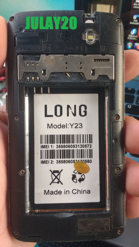

LONG Y23 PASSWORD NO HARD RESET DONE

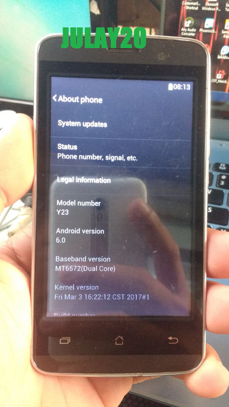

History:

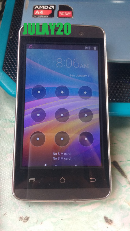

nakalimotan ni tumer ang password dinala sa ebang tech di kinaya kc walang hard reset
ganito ginawa ko
dahil walang hard reset

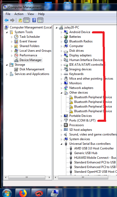

silip ko mona kon naka on yung ADB
go to my computer
silip kong naka on ang ADB
pag my nakita kang Andriod Divece

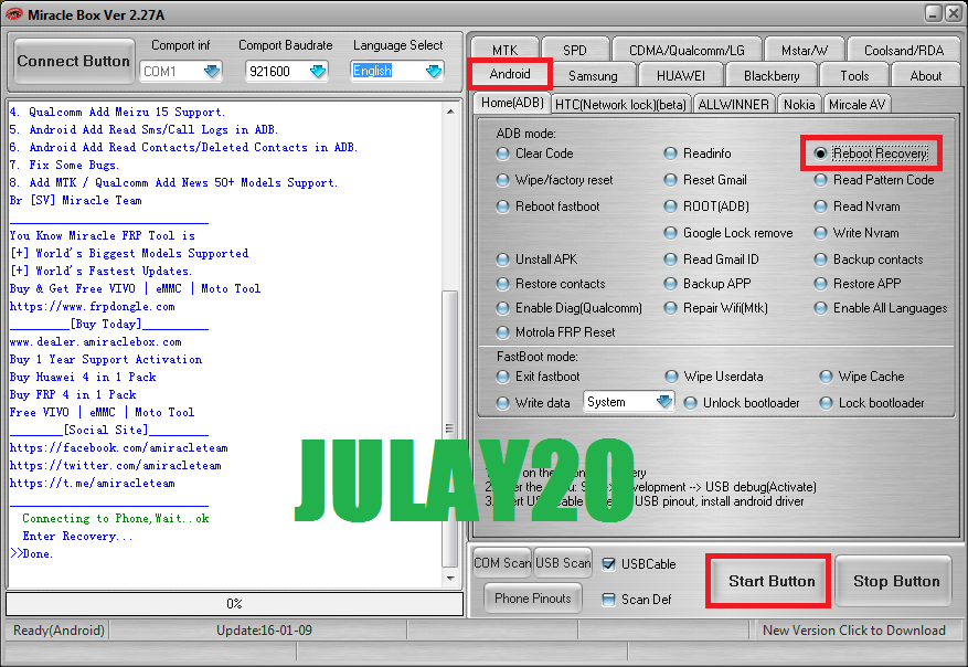

naka on yung ADB nito kaya e tray natin sa mga tool's yung sakin Miracle Crack
ang ginamit ko :D
Prucedure:
open miracle crack
click andriod
Home ADB
reboot recovery
saksak USB sa cp
kilangan naka on ang unit

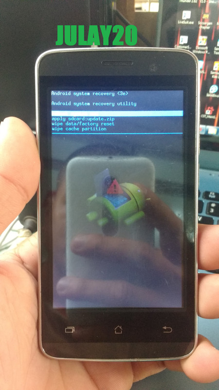

hit start button :D wait.... gang lomabas yung Andriod system recovery
pag lomabas na yung andriod system recovery
gamitin yung voll up and down and power button

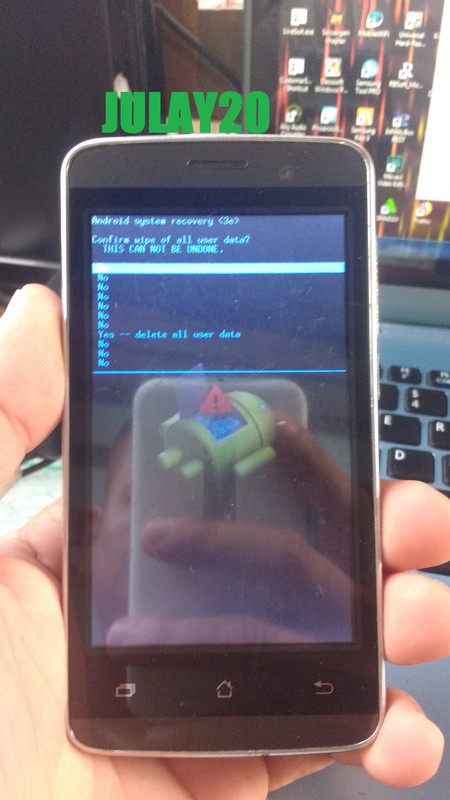

select wipe data factory reset power button
select yes power button format complet...
reboot mo na :D
