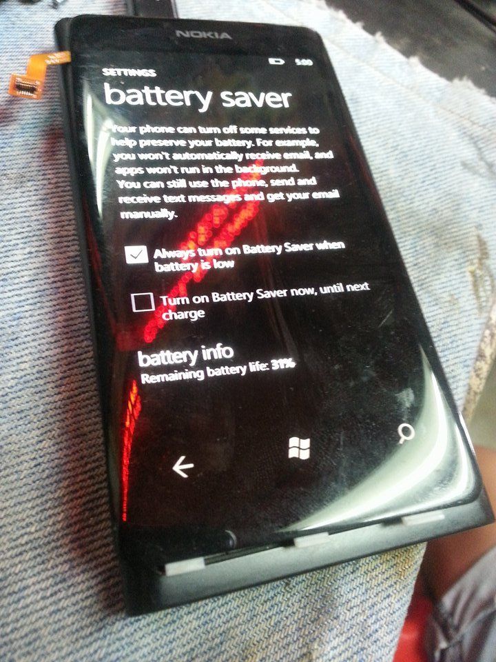

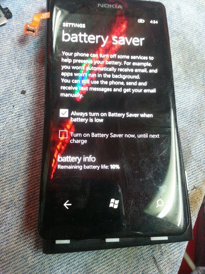

First check battery charge in power supply after ilang minuto
test aba'y nag on test if nag charge but negative disassemble unit

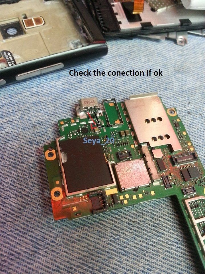

may repair na ung charging port at na replaced na rin so check ko

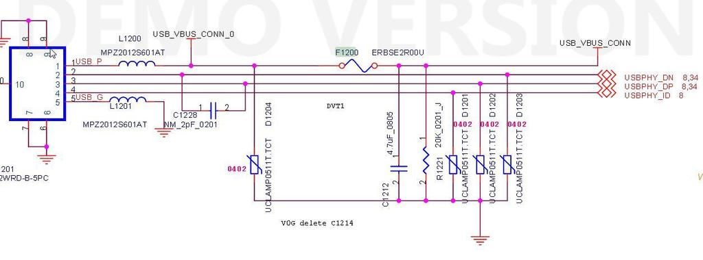

conection but shorted sa charging pin check schematic diagram
para sa solution.
check my screen shot
Charging ways Schematic

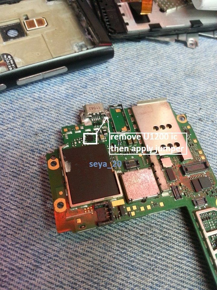

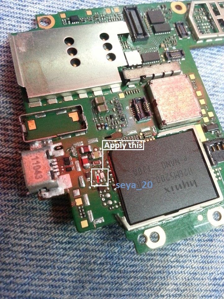

after remove ng U1200 nawala short sa charging pin nag charge but fake charging
so apply ko nalang jumper
Done..!!! :D:D:D
