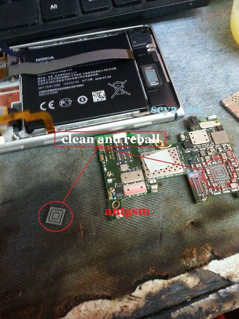

Problem
No Power Bigla nalang daw na deads
Action Taken
Charge Battery and turn it on but totally dead
hindi rin detected sa pc charging pin is ok
then proceed to bagito hardware moves...!

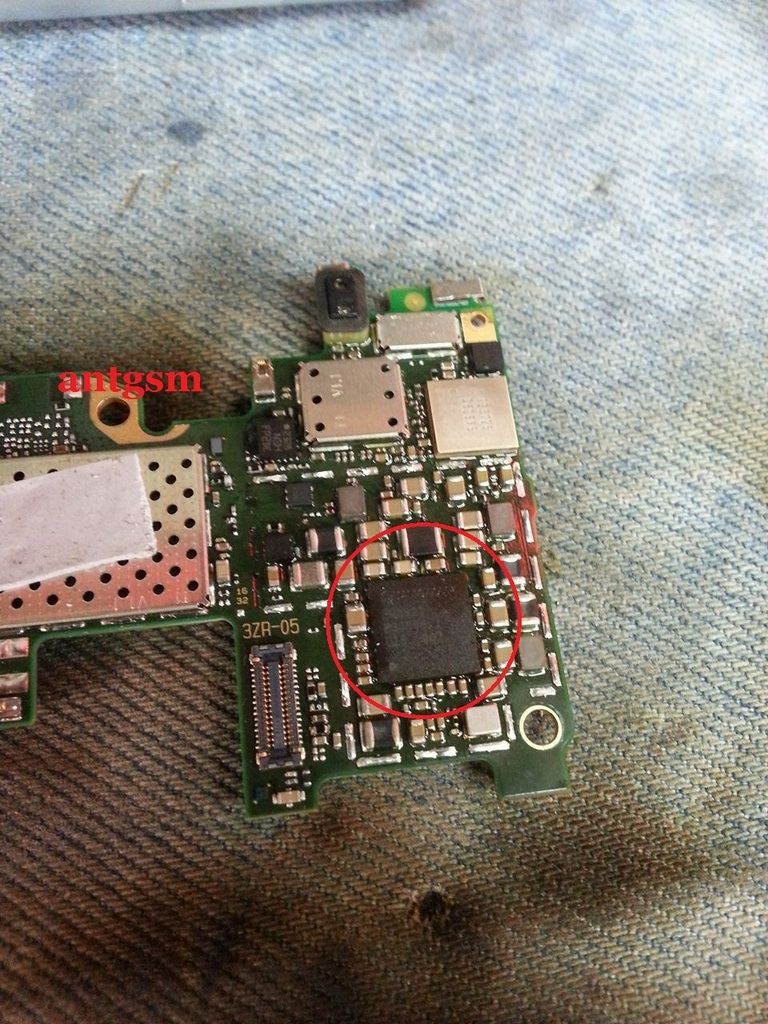

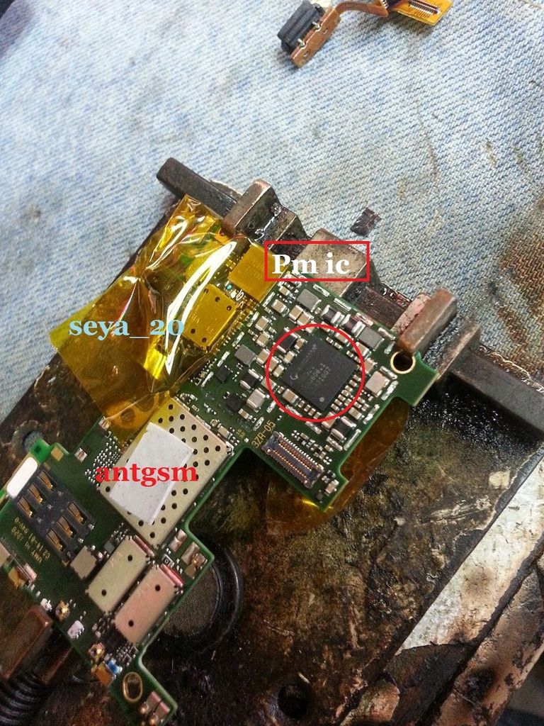

first mild reheat pm ic abay nag on ngunit
after ilang minuto deads ulit :D
so i decided to remove pm ic then reball

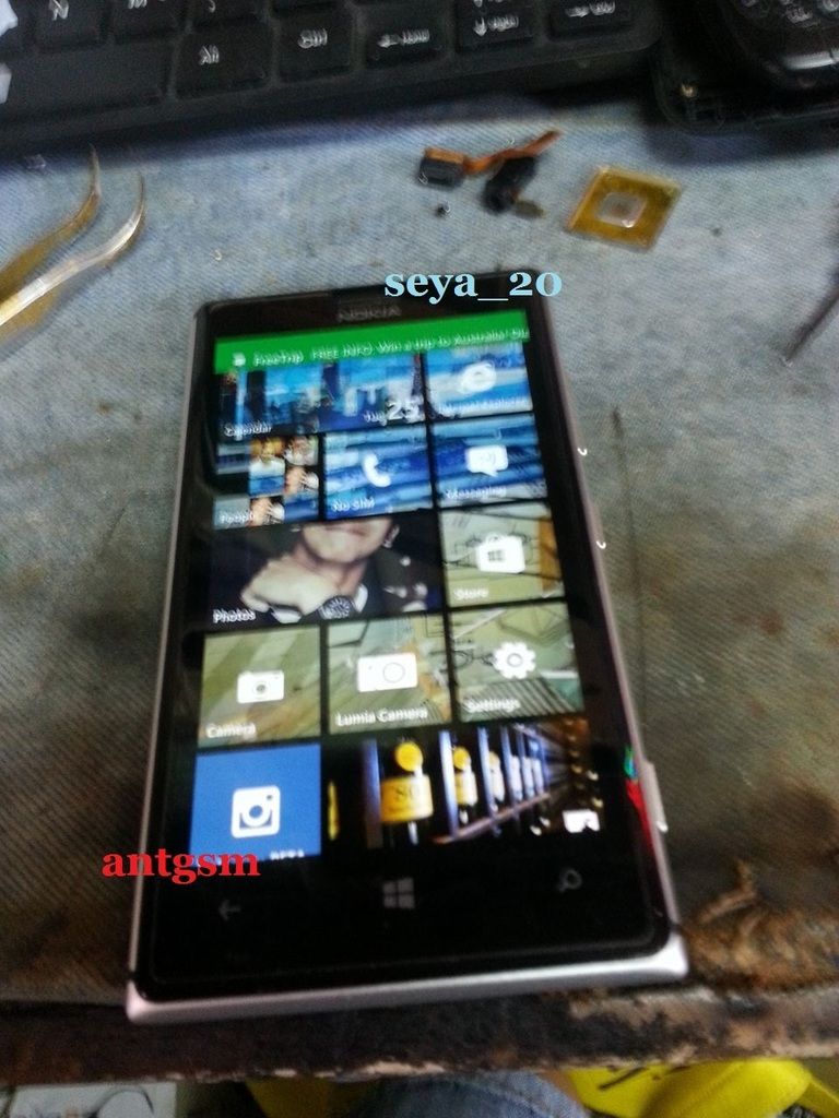

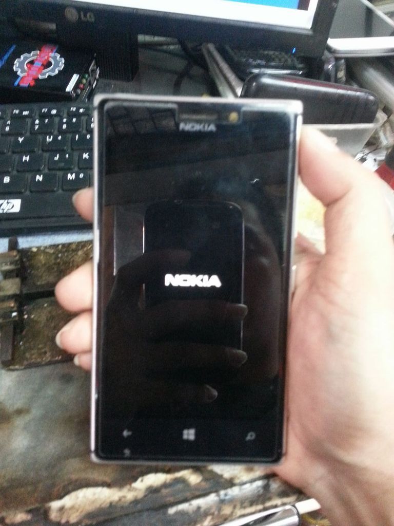

at boom...!! :)))
Done..!!!​
