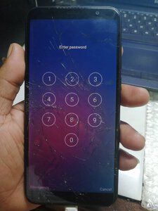

REFERENCE MEIZU M6T (M811H) PASSWORD DONE via OCTOPLUS FRP TOOL.

meizu m6t {m811h}

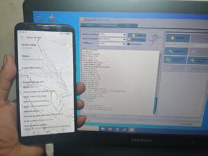

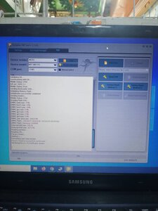

open octoplus frp tool
select-
device vendor (meizu)
device model (m6t m811h)
comport (com3)
click (factory reset method 1)
off muna unit then hold vol up & down
& connect usb cable
(if operation was failed.try again)
done.
