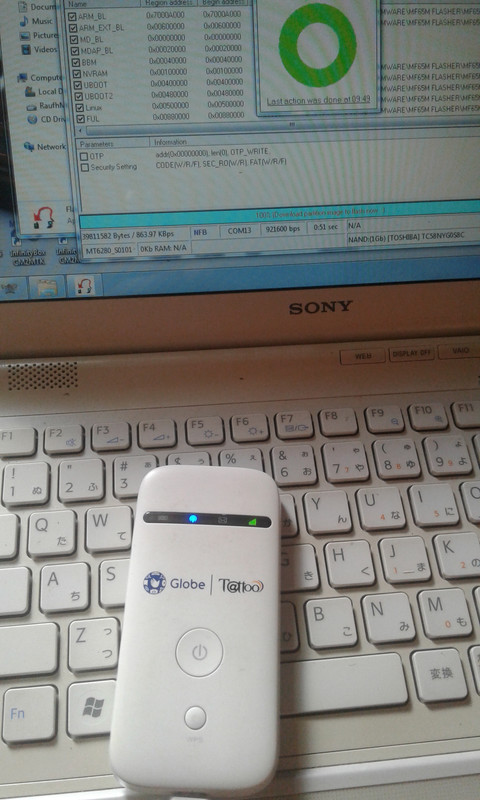

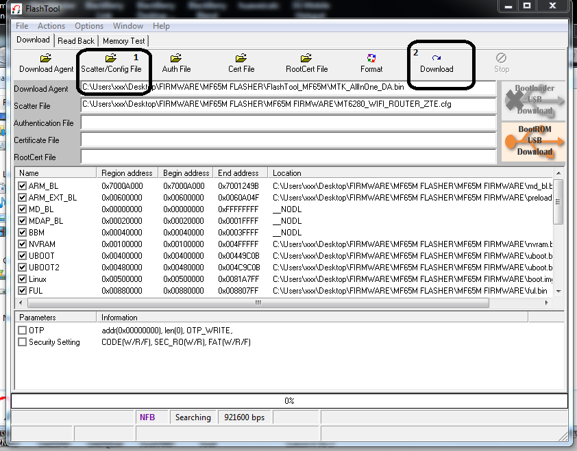

Open Flashtool
LOAD SCATTER FILE then HIT DOWNLOD
dapat naka off ang unit then insert usb cable
wala na po tayong pipindutin automatic yan mag FLASH

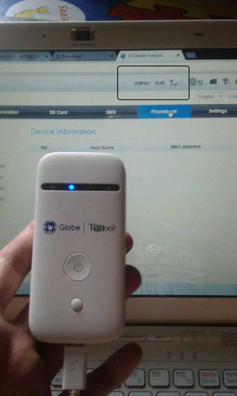

flashing Done
Result

thank you Very much boss,,,, I really nrrd this Badly....
Tested

FLASH TOOL ERROR: S_COM_PORT_SEARCH_TIMEOUT (1037)
ganyan ang lumalabas boss. pano ba ito? salamat sa sasagot.

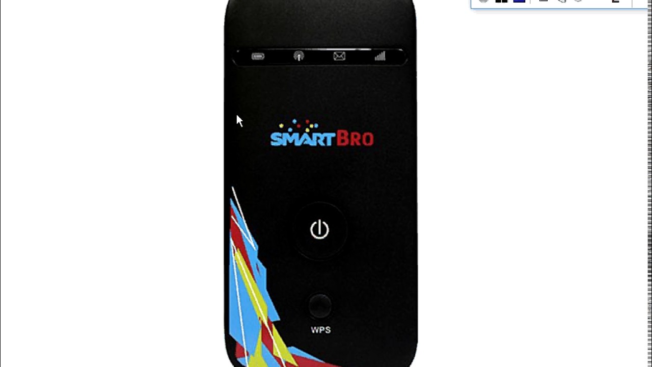

tested... Sa Smartbro.. yung default password nang wifi nagiging 'admin'...nice.,. tnx ts..
