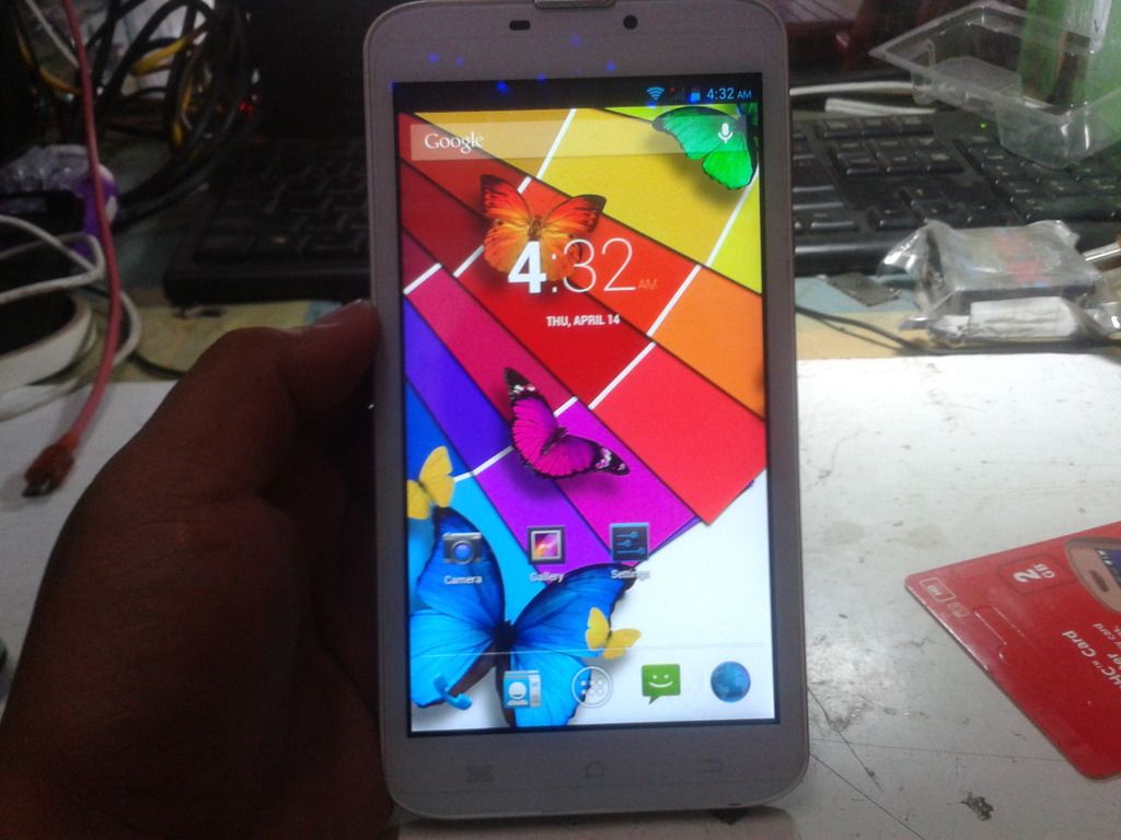

MIPAD S6 VIRUS PROBLEM DONE SA FLASHING
BUTI NALANG MY NA BACKUP GALING SA GOOD UNIT DIN

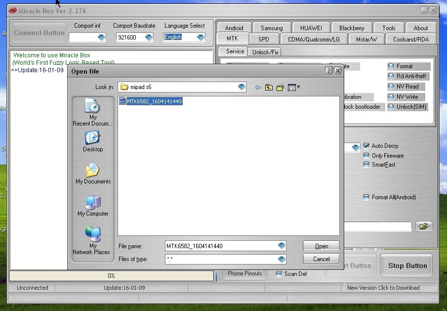

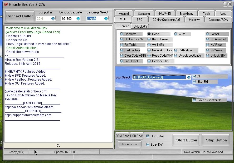

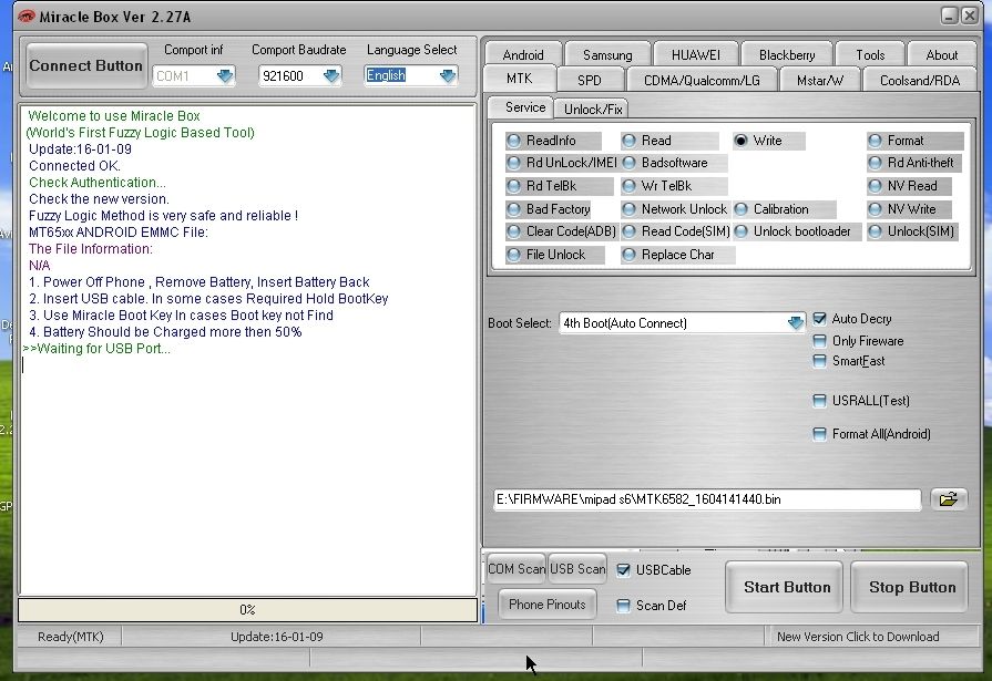

1.FIRST PO RUN MIRACLE 2.27A CRACK
2.CLICK ON MTK
3.UNDER MTK TAB TICK WRITE
4.LOAD FIRMWARE
5.TICK START BUTTON......

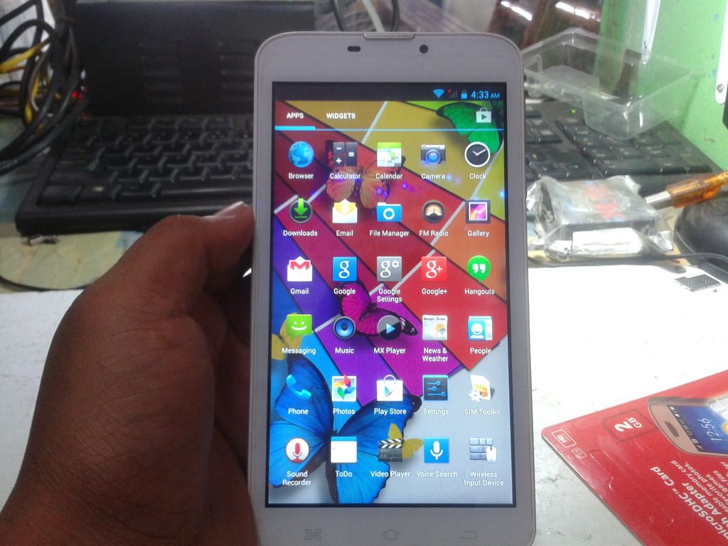

TAPOS SMILE KANA :) WAIT MATAPOS ANG FLASHING

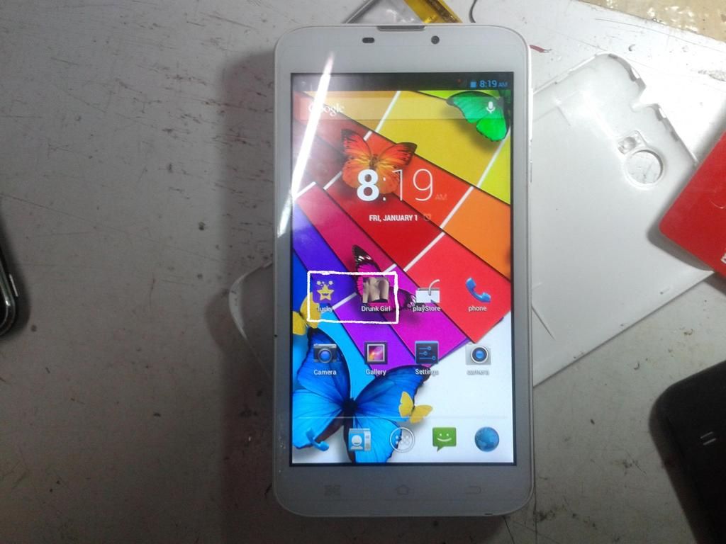

PAG TAPOS NG FLASH HANG SA LOGO....
ALAM NA NATIN GAGAWIN JAN HARD RESET MUNA...
6.TAPOS PWEDE KANA MAG SMILE ULIT OK NA...
DONE.......{}{}{}:)
TRY KO CONNECT SA WIFI KUNG MAG HANG WALA NA HEHEHEEEEE:):):)
