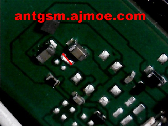

Moto G2 XT1068 Touch only not working.
1st Replace Good working Touch with LCD combo if same problem then check any water damage near lcd connector.
check any Components short if short remove & check.
finally solution is below remove this crystal ic & then make one jumper now problem solved for me.
See picture:
See picture:
