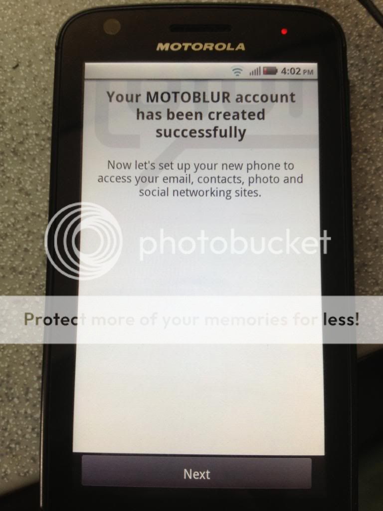

*FULLY TURN ON THE PHONE W/O SIM
*CONNECT TO PC
*IF SUCCESSFULLY CONNECTED IN THE UPPER PART OF SCREEN OF THE PHONE TAP,HOLD
& SLIDE DOWN ON USB MOBE SELECT "CONNECTED AS INSTALLER OR USB DEBUG"
*INSTALL THE DRIVER COMPLETELY

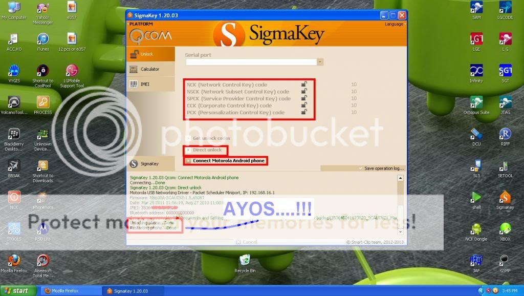

*CONNECT YOUR SIGMAKEY
*OPEN THE EXE.
*CLICK TAB "PLATFORM"
*SELECT "QUALCOM" TAB
*HIT "UNLOCK"
*HIT "CONNECT MOTOROLA ANDROID PHONE" AUTOMATIC HAHANAPIN NA NYA YUNG
COMPORT NO NEED TO BROWSE
*AND FINALLY HIT "DIRECT UNLOCK"

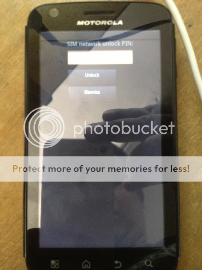

JUST LIKE THIS..!!
FINISHED JOB WELL DONE!
