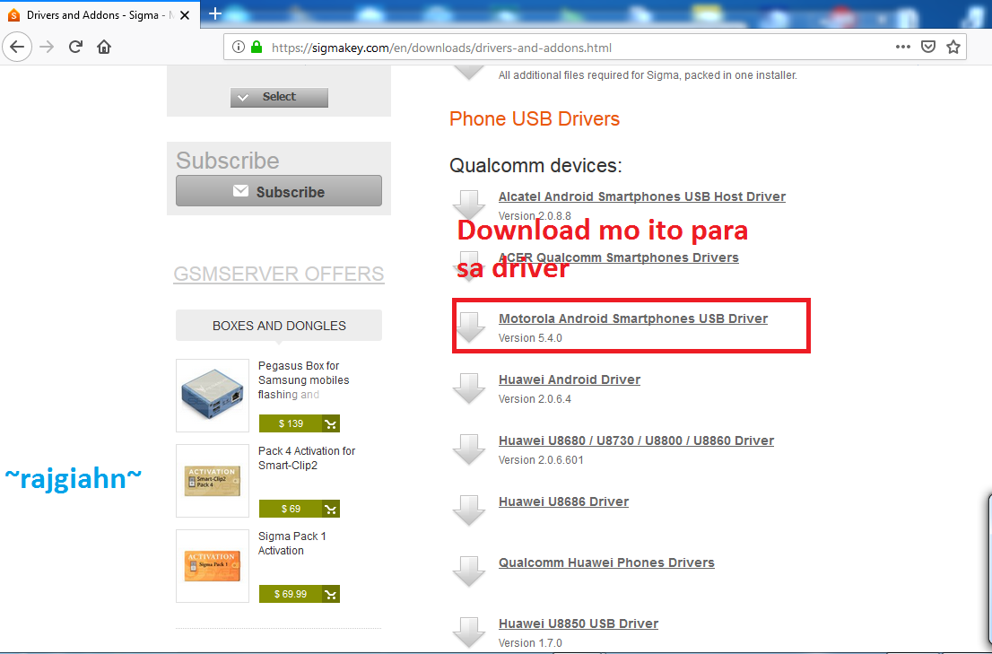

1. Download ka muna ng Motorola Driver from Sigmakey.com na site

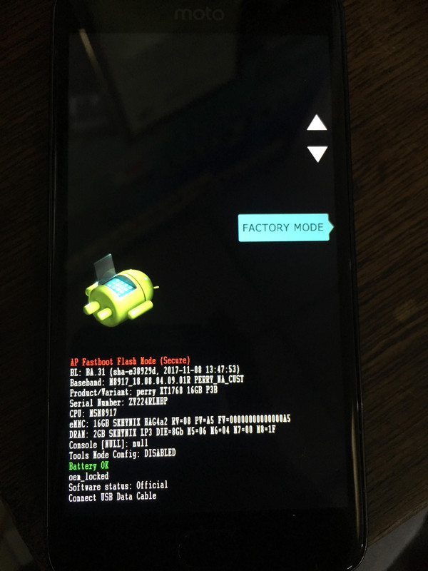

2. Set mo ang Unit to FACTORY MODE , Off mo ang unit then Press Vol - at Vol+ then pres power, piliin mo yung Factory Mode, then set by pressing power button,

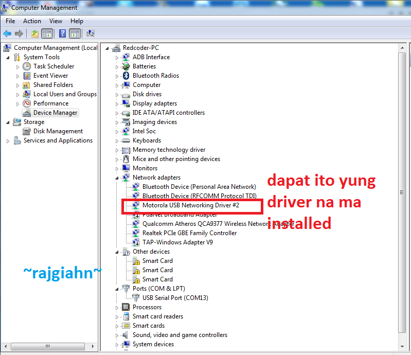

3. salpak mo ang unit sa computer, tingnan mo sa Computer Device Manager Dapat ito ang nka installed, Motorola USB Networking Driver
then tingnan mo sa Computer Device Manager if nka Installed na

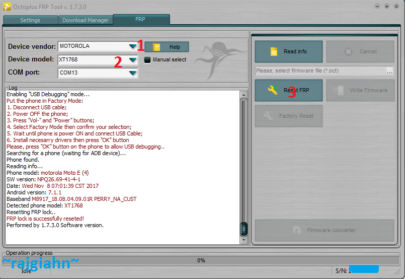

4. Open mo Octoplus Frp Tool, Select ang unit Motorola then model xt1768 then press Reset FRP
