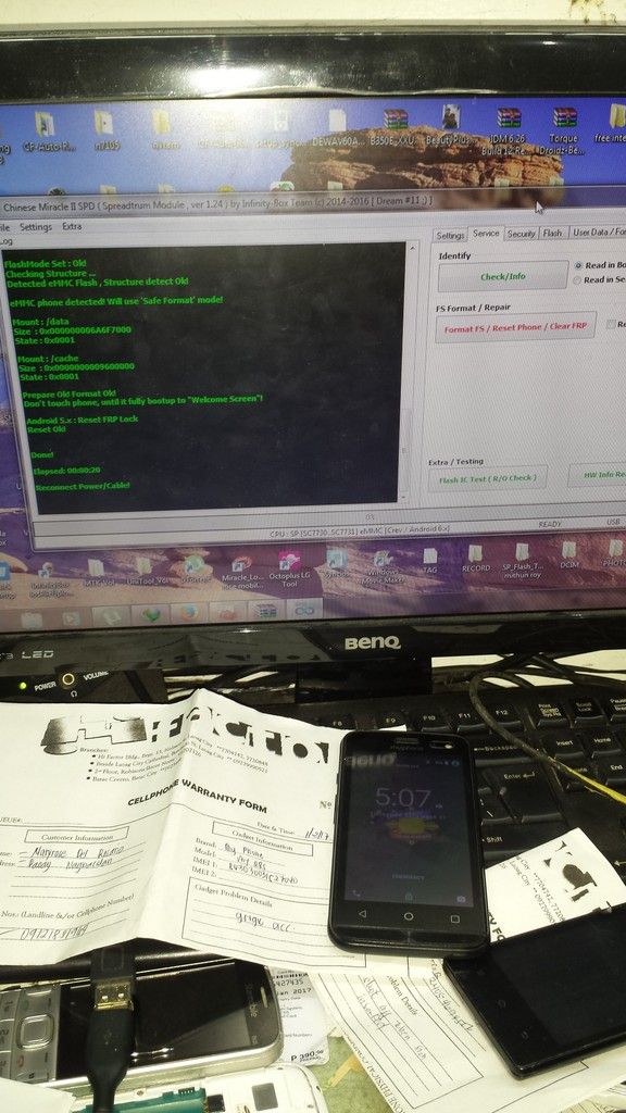

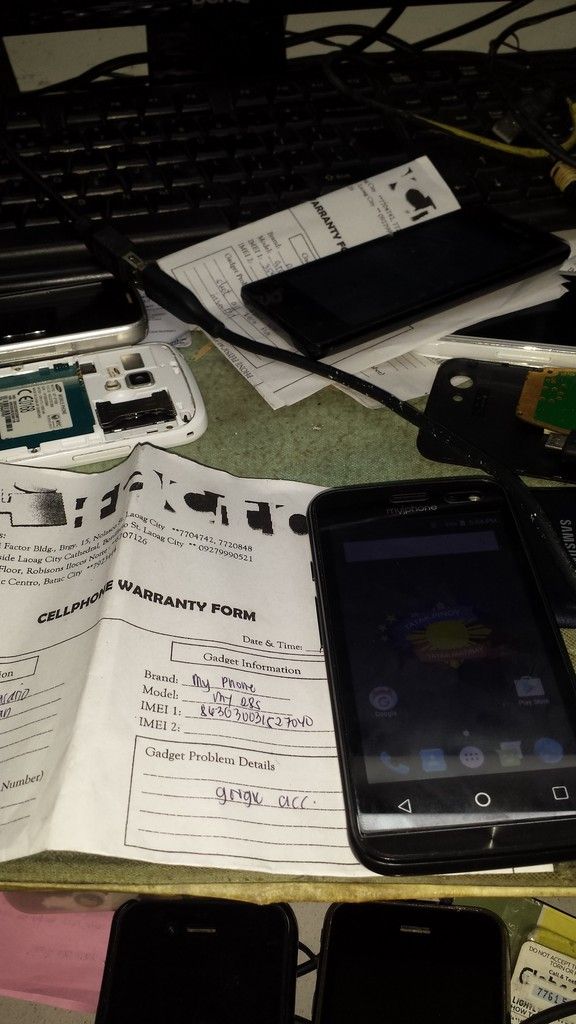

livestrong
pinahirapan ako neto...pero ayos lang madami natutunan
done in cm2...hindi lahat isusubo...
importante is kaya ng cm2...
logs
Card found: S/N : AB5829B3 , v0134
Chinese Miracle II [SPD module] v 1.24
Operation : Format File System / Reset Settings [ v1.24 ]
Settings : SmartFormat is On
1. Remove battery. Insert battery back
2. Press and hold 'VolumeUp' and 'VolumeDown' keys
3. Insert cable
==== Wait for phone...
Phone found! [ 17 ]
Port Opened
Sync...
InitBoot Done [ 0x81 ] , Ver : SPRD3
Sync...
Sending FDL
[Info] : If SW freeze here more, than 15 seconds - remove cable
Boot failed!
DS : Loader start failed! Wrong Model selection!
Boot failed!
Reconnect Power/Cable!
3. Insert cable
Phone found! [ 17 ]
Port Opened
Sync...
Sync...
Sending FDL
FDL Ready!
Boot Ver : SC7731 Crev eMMC Loader v2.0
Sending FLASH FDL
FLASH FDL Ready!
Boot Ok!
FlashMode Set : Ok!
Checking Structure ...
Detected eMMC Flash , Structure detect Ok!
eMMC phone detected! Will use 'Safe Format' mode!
Mount : /data
State : 0x0001
Mount : /cache
State : 0x0001
Prepare Ok! Format Ok!
Don't touch phone, until it fully bootup to "Welcome Screen"!
Android 5.x : Reset FRP Lock
Reset Ok!
Done!
Elapsed: 00:00:20
ayos...
