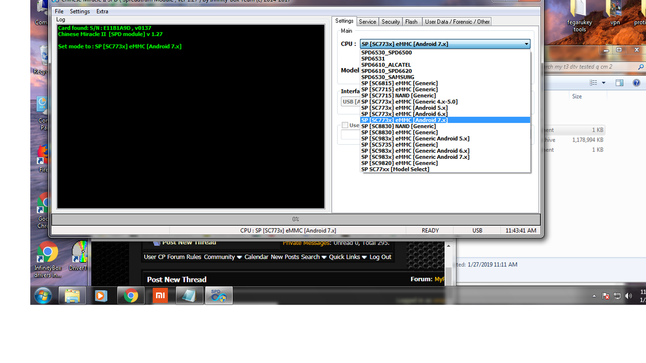

next,,, extract mo yung files na dinownload mo,,tapos ope mo c cm2 mo punta setting ilagay sa sp773x 7.0 parang ganito oh,,, hehe natatawa pero ok lng follow rule#23

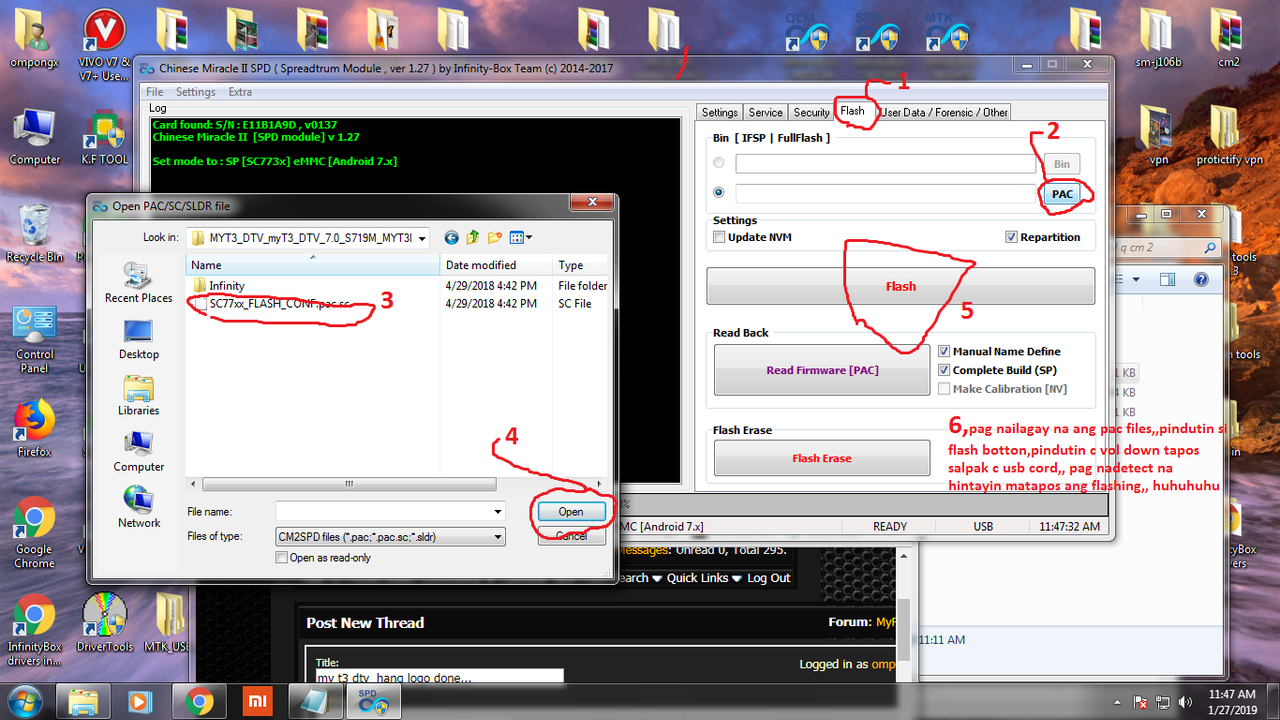

next,,, sundan mo lng to,,at basahin mo,,,

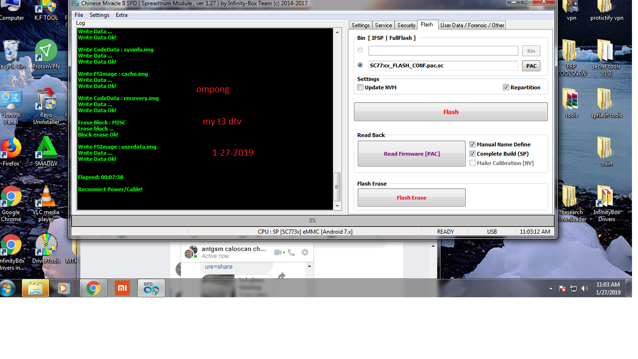

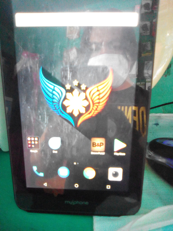

finish,,,
