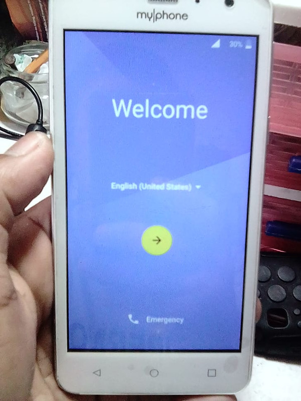

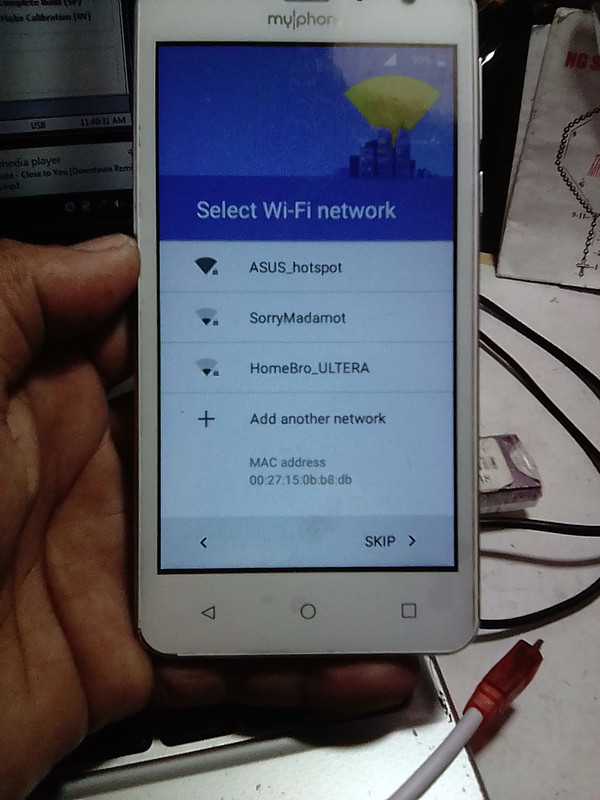

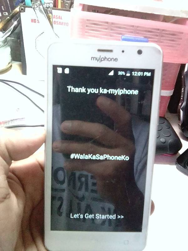

MY76 DTV Hang on logo done at credit sa orig uploader ng FW galing kay paring google NAKITA KO PO yung firmware
done using Cm2... pac files pwede rin po sa SPD Tool
ito po link : MY76_DTV.Firmware
ito po SS....

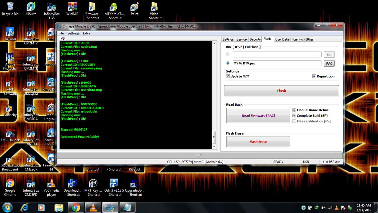

Card found: S/N : DCAC1948 , v0137
Chinese Miracle II [SPD module] v 1.27
Set mode to : SP [SC773x] eMMC [Android 6.x]
Loading : MY76 DTV.pac
CRVersion : BP_R1.0.0
PacCPUinfo : SC77xx
PacVersion : SC7731_eMMC_MY76 DTV---MOXX_INFINITY-BOX
FastCheck : 0x00A411AF45
Loading files ...
File : Infinity_fdl1.bin
File : Infinity_fdl2.bin
File : nvitem_w.bin
File : nvitem_wcn.bin
File : prodnv.img
File : u-boot-spl-16k.bin
File : sc7731C_CP0_modem.bin
File : DSP_DM_Gx.bin
File : sc8830g_modem_CP2_WCN_Trunk_W16.28.5_Release.bin
File : logo_480x854.bin
File : fblogo_480x854.bin
File : boot.img
File : system.img
File : sysinfo.img
File : cache.img
File : recovery.img
File : userdata.img
File : u-boot.bin
File : Infinity_SC77xx.xml
Load Ok!
Operation : Flash [ v1.27 ]
======= Flash
Files set for flashing :
[ MCU ] : MY76 DTV.pac
PacCPUinfo : SC77xx
File : nvitem_w.bin
File : prodnv.img
File : boot.img
File : system.img
File : sysinfo.img
File : cache.img
File : recovery.img
File : userdata.img
File : u-boot.bin
1. Remove battery. Insert battery back
2. Press and hold 'VolumeUp' and 'VolumeDown' keys
-> Alternative : just ONE 'VolumeUp' or 'VolumeDown' key
3. Insert cable
==== Wait for phone...
Phone found! [ 52 ]
Port Opened
Sync...
InitBoot Done [ 0x81 ] , Ver : SPRD3
Sync...
Sending FDL
[Info] : If SW freeze here more, than 15 seconds - remove cable
PickUp loaders from pac
FDL Ready!
Boot Ver : Spreadtrum Boot Block version 1.1
Sending FLASH FDL
FLASH FDL Ready!
Boot Ok!
FlashMode Set : Ok!
[FL] : Enabled NVM update. Will program all NVM images found in FW !
PMTManager : Load 0x19 records
PMTManager : PMT Update Ok!
Flashing now
[FlashProc] : NVM Update
Current ID : NV_W
Current Part : wfixnv1
[FlashProc] : Ok!
Current ID : NV_WCN
Current Part : wcnfixnv1
[FlashProc] : Ok!
[FlashProc] : CODE
Current ID : PRODNV
Current File : prodnv.img
Flashing now ...
[FlashProc] : Ok!
[FlashProc] : ERASE
Current ID : ERASEUBOOT
Current Part : uboot
[FlashProc] : Ok!
[FlashProc] : ERASE
Current ID : FLASH
Current Part : wruntimenv1
[FlashProc] : Ok!
[FlashProc] : ERASE
Current ID : FLASH_WCN
Current Part : wcnruntimenv1
[FlashProc] : Ok!
[FlashProc] : ERASE
Current ID : ERASEMISC
Current Part : misc
[FlashProc] : Ok!
[FlashProc] : BOOTCODE
Current ID : SPLLOADER
Current File : u-boot-spl-16k.bin
Flashing now ...
[FlashProc] : Ok!
[FlashProc] : CODE
Current ID : MODEM_W
Current File : sc7731C_CP0_modem.bin
Flashing now ...
[FlashProc] : Ok!
[FlashProc] : CODE
Current ID : DSP_W
Current File : DSP_DM_Gx.bin
Flashing now ...
[FlashProc] : Ok!
[FlashProc] : CODE
Current ID : MODEM_WCN
Current File : sc8830g_modem_CP2_WCN_Trunk_W16.28.5_Release.bin
Flashing now ...
[FlashProc] : Ok!
[FlashProc] : CODE
Current ID : BOOTLOGO
Current File : logo_480x854.bin
Flashing now ...
[FlashProc] : Ok!
[FlashProc] : CODE
Current ID : FASTBOOT_LOGO
Current File : fblogo_480x854.bin
Flashing now ...
[FlashProc] : Ok!
[FlashProc] : CODE
Current ID : BOOT
Current File : boot.img
Flashing now ...
[FlashProc] : Ok!
[FlashProc] : IMAGE
Current ID : SYSTEM
Current File : system.img
Flashing now ...
[FlashProc] : Ok!
[FlashProc] : CODE
Current ID : SYSINFO
Current File : sysinfo.img
Flashing now ...
[FlashProc] : Ok!
[FlashProc] : IMAGE
Current ID : CACHE
Current File : cache.img
Flashing now ...
[FlashProc] : Ok!
[FlashProc] : CODE
Current ID : RECOVERY
Current File : recovery.img
Flashing now ...
[FlashProc] : Ok!
[FlashProc] : IMAGE
Current ID : USERDATA
Current File : userdata.img
Flashing now ...
[FlashProc] : Ok!
Current ID : UBOOTLOADER
Current File : u-boot.bin
Flashing now ...
[FlashProc] : Ok!
Elapsed: 00:05:27
Reconnect Power/Cable!

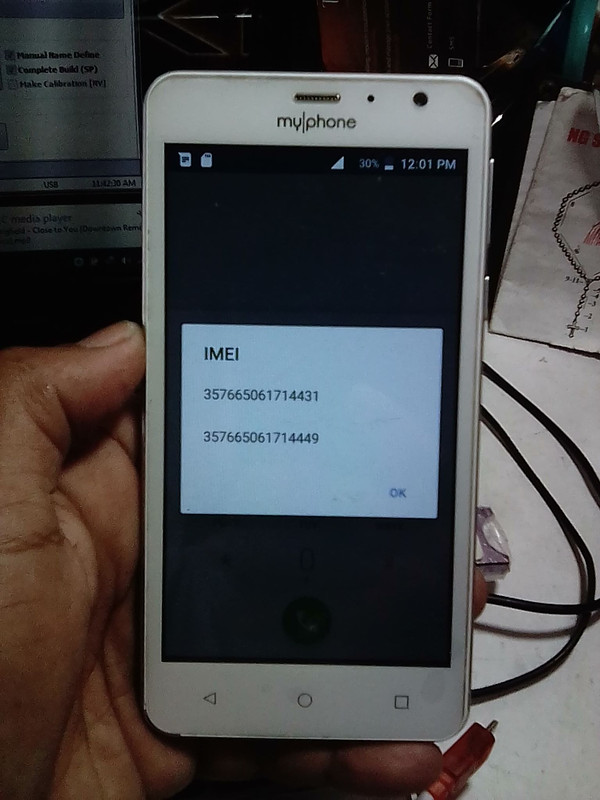

Note : lagyan check nyo po Update nvm para di mawala IMEI nya kasi unang flash ko po walang IMEI kaya inulit ko po at nilag yan ko po check yung NVM...
