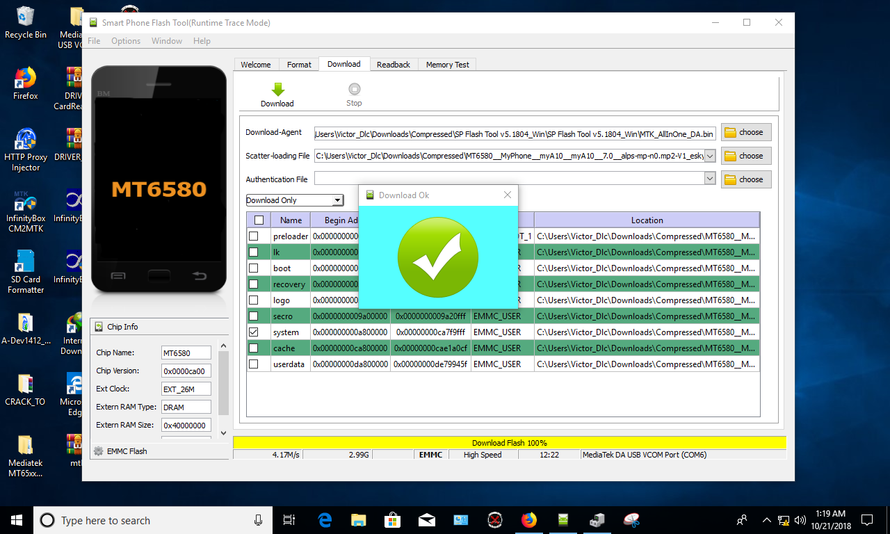

dead phone di ma flash flash error 4058 apat na shop na daw umayaw
format + download ginawa ko pwede naman siguro download lang using sp flash tool
spflashtool load the scatter hit the download button remove battery hold the vol+ , insert usb cable and insert battery WAIT UNTIL DONE...... Sa screenshot ko system lang flash ko peru inulit ko sa format + download para malinis
