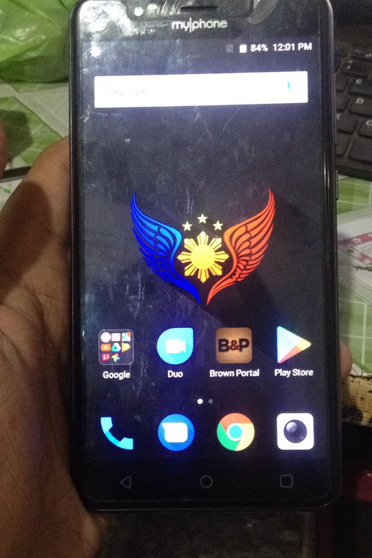

MY A10DTV
PROBLEM HANG
ACTION TAKEN

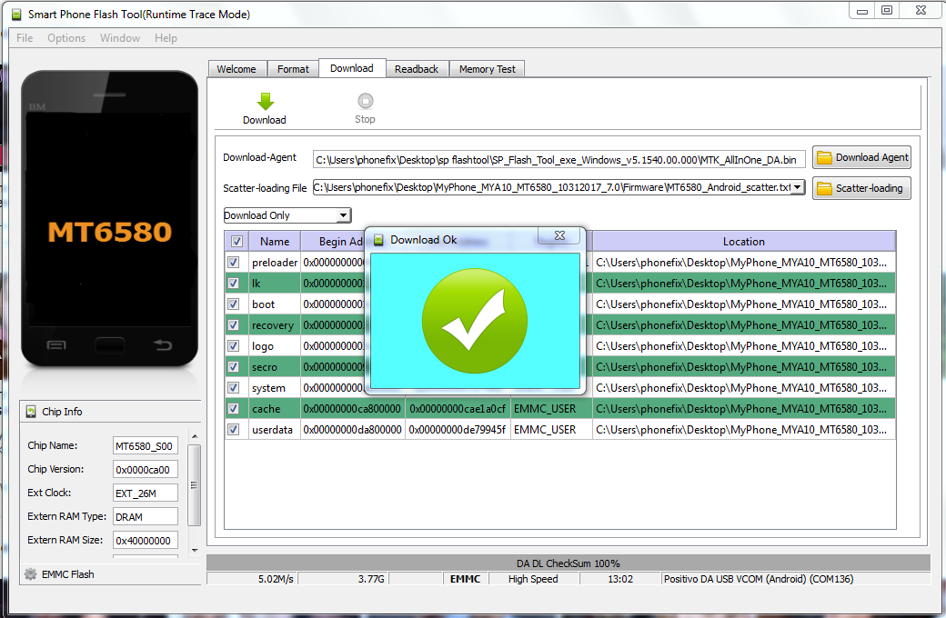

after download proceed na sa flashing
via spflashtool

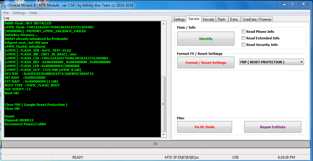

after flashig frp naman
via cm2 mtk

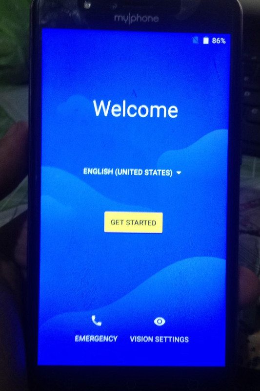

done done

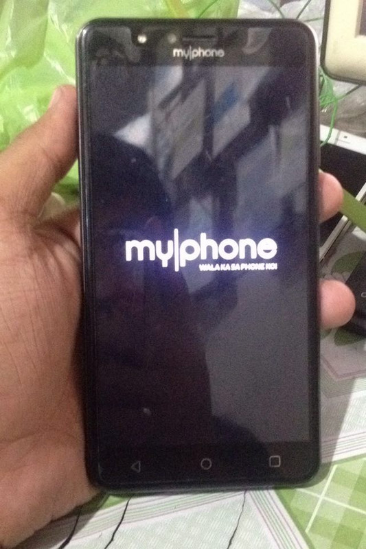

MY A10DTV
PROBLEM HANG
ACTION TAKEN
HARD RESET NO LUCK
via spflashtool
