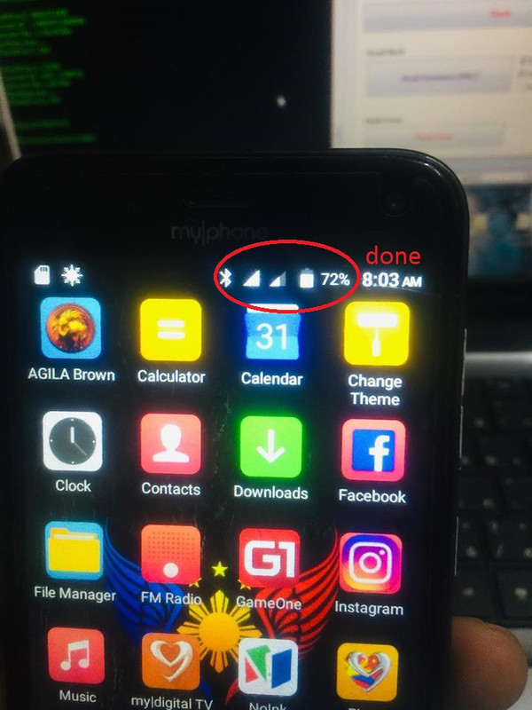

myA7 PROBLEM
Not detectincg simcard kahit meron sim at ok ang simslot...

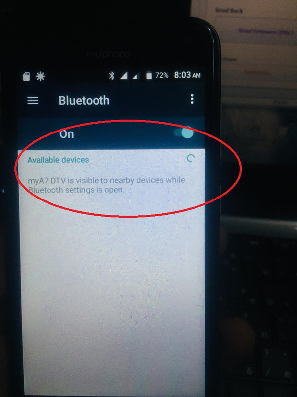

Ayaw mag connect ng wifi at bluetooth...

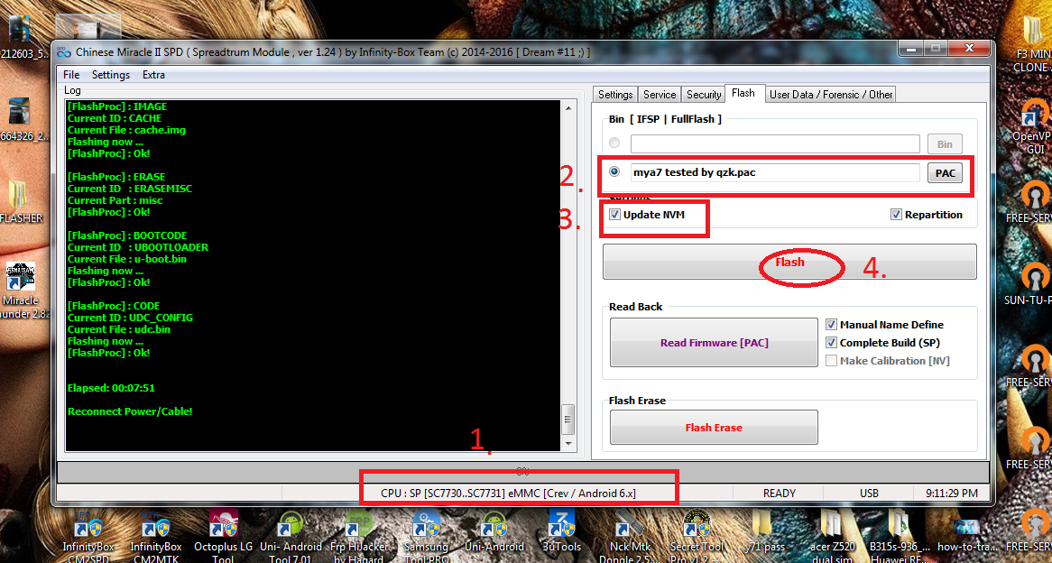

Solution ginawa ko, Flahing tested firmware...
Open cm2 spd
Select Correct CPU
Load PAC file
Check nyo update NVRAM na sa screenshot po..
Then tick FLASH and wait hanggang matapos and smile...
