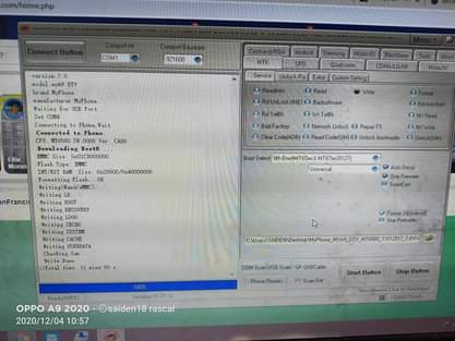

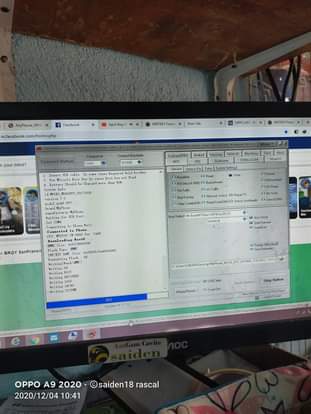

PROCEDURE
CLICK /MREACLE DONGLE
CLICK/MTK
CLICK/SERVICE
CLICK/WHITE
CLICK/BOOT SELECT
CLICK TAB 8TH/BOOT/MT65XX
THEN SCATER UNG FILE
CLICK /ONLY FARMWARE
CLICK/ FORMAR ALL ANDROID
THEN START BUTTON
HOLD VOLUME UP
THEN INSERT USB
WAITING DONE

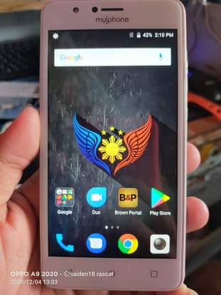

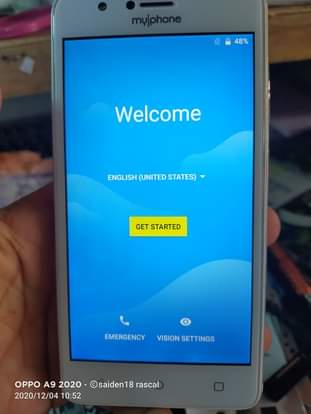

HANG LOGO PO YAN HENDE
KULANG NAPICTURAN
WALA NA SYANG FRP
