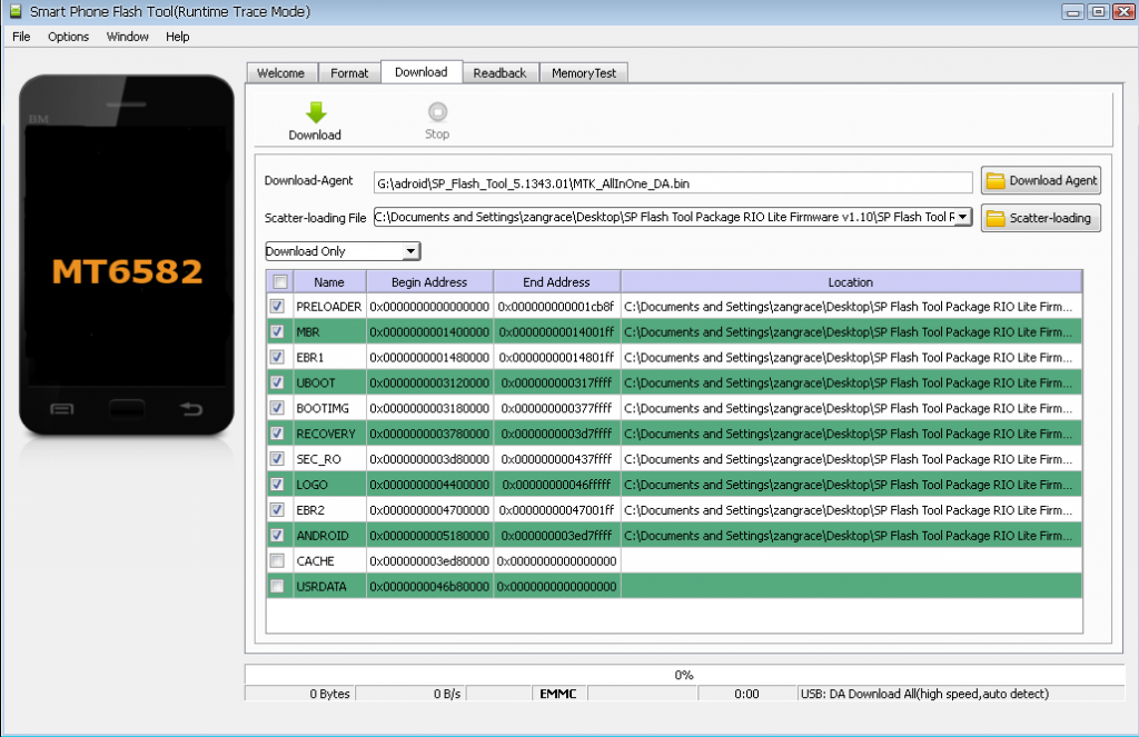

myphone agua rio lite hang logo done
una hard reset
logo parin
pangalawa
hanap firmware
dl muna hintay ilang minuto
http://www.4shared.com/get/q8ctJ9opba/SP_Flash_Tool_Package_RIO_Lite.html
open sp flash tool
load firmware
scatterfile '

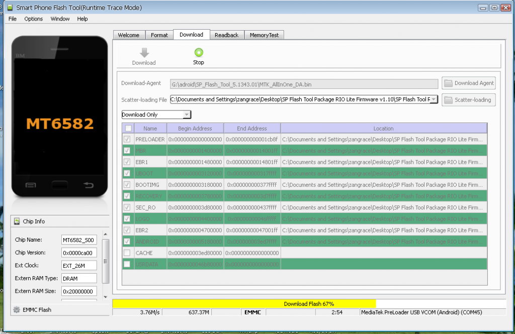

salpak battery hold volume down
connect micro-uart
click download waiting until done
check imei
done tested file yan
