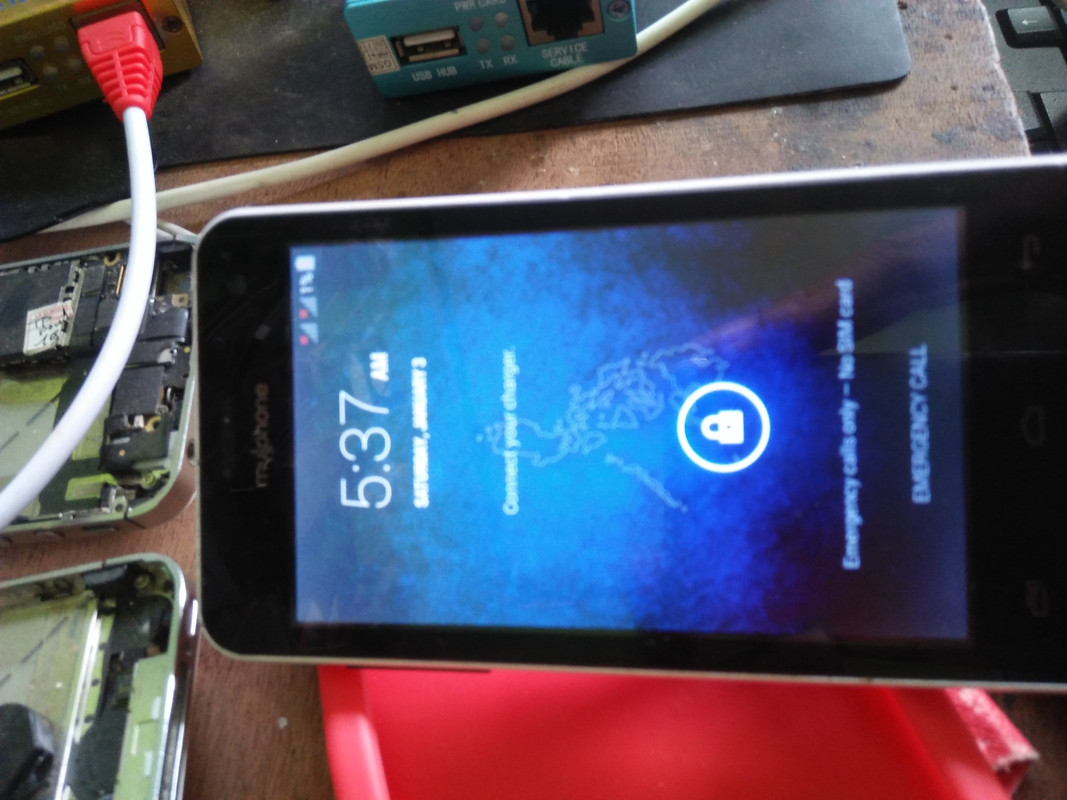

morning sa lahat share ko lang my21 no power
Phone found! [ 53 ]
Port Opened
Sync...
InitBoot Done [ 0x81 ] , Ver : SPRD3
Sync...
Sending FDL
[Info] : If SW freeze here more, than 15 seconds - remove cable
FDL Ready!
Boot Ver : SC773x Android 5.x eMMC v1.0 Inf
Sending FLASH FDL
FLASH FDL Ready!
Boot Ok!
FlashMode Set : Ok!
PMTManager : Load 0x18 records
PMTManager : PMT Update Ok!
Flashing now
Update BootCode : u-boot-spl-16k.bin
Write Data ...
Write Data Ok!
Update BootCode : u-boot.bin
Erase block ...
Block erase Ok!
Write Data ...
Write Data Ok!
Write FSImage : prodnv.img
Write Data ...
Write Data Ok!
Write CodeData : sc7731g_CP0_modem.bin
Write Data ...
Write Data Ok!
Write CodeData : DSP_DM_Gx.bin
Write Data ...
Write Data Ok!
Erase Block : RuntimeData
Erase block ...
Block erase Ok!
Write CodeData : sc7731g_modem_CP2_WCN_14E_W15.16_Release.bin
Write Data ...
Write Data Ok!
Erase block ...
Block erase Ok!
Write CodeData : logo_480x800.bin
Write Data ...
Write Data Ok!
Write CodeData : hwinfo.img
Write Data ...
Write Data Ok!
Write CodeData : boot.img
Write Data ...
Write Data Ok!
Write FSImage : system.img
Write Data ...
Write Data Ok!
Write FSImage : cache.img
Write Data ...
Write Data Ok!
Write CodeData : recovery.img
Write Data ...
Write Data Ok!
Erase Block : MISC
Erase block ...
Block erase Ok!
Write FSImage : userdata.img
Write Data ...
Write Data Ok!
Erase Block : INTERNALSD
Erase block ...
Block erase Ok!
Elapsed: 00:03:53
Reconnect Power/Cable!
firmware http://www.mediafire.com/file/6hkkpmnw94jzcg1/Myphone_My21.rar/file
sana mkatulong sa kapwa tech​
