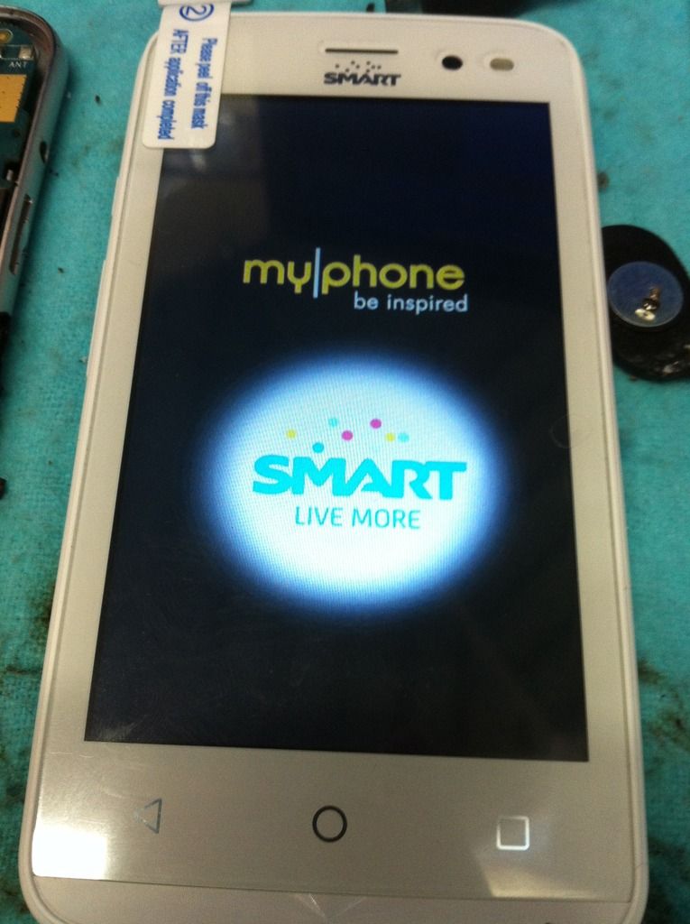

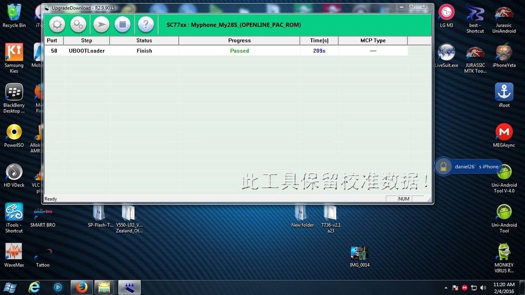

MY phone my28s
galing sa smart
note: pag katapos ninU flash pag mag black screen siya hold lng power button din click ninU restart
next hard reset ninu nlng using setting

to walang pasword tested na
Firmware: MyPhone_My28s_Openline_Firmware_v1.rar
Upgrade Download Tool: UPGRADEDOWNLOAD_R2.9.9015.rar
SPRD NPI USBDriver: SPRD_NPI_USB_Driver.rar

Walang Version yan pero dalawang klase ang my28s, may dualband and triband.
pag meron sticker 3 doon sa bandang battery nya ibig sabihin triband yan.
