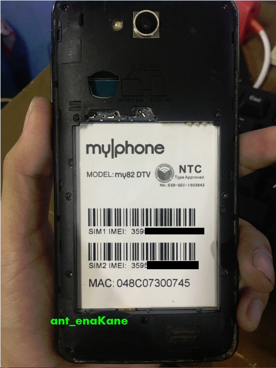

UNIT: MY82_DTV

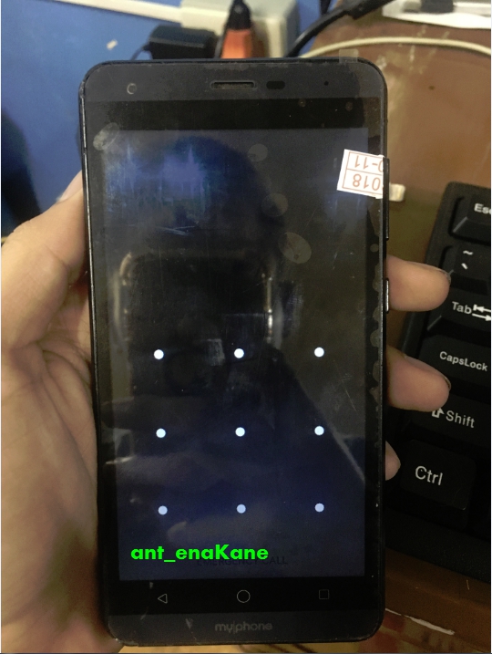

ISSUE: FORGOT PASSWORD

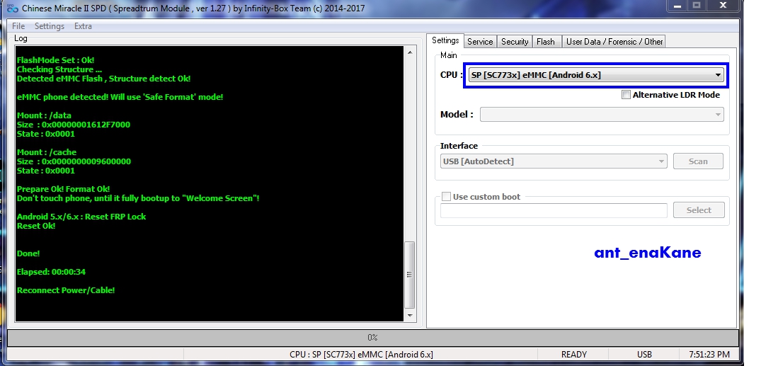

OFF UNIT
OPEN CM2SPD
SELECT SC773XX eMMC Android 6.X

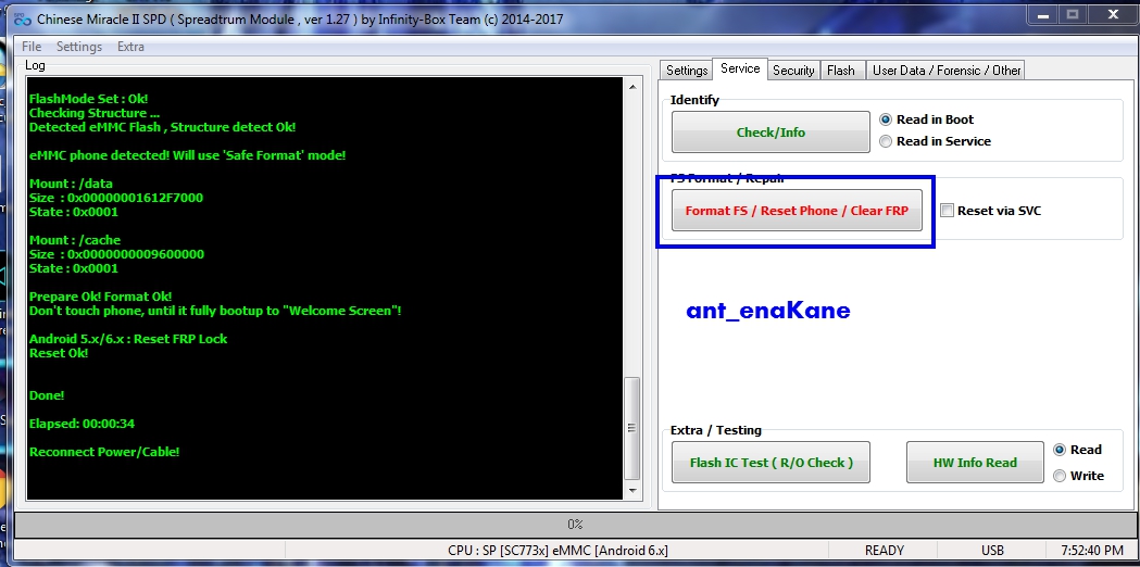

SELECT SERVICE
CLICK FORMAT FS
DONE :-bd :-bd :-bd :-bd :-bd :-bd
