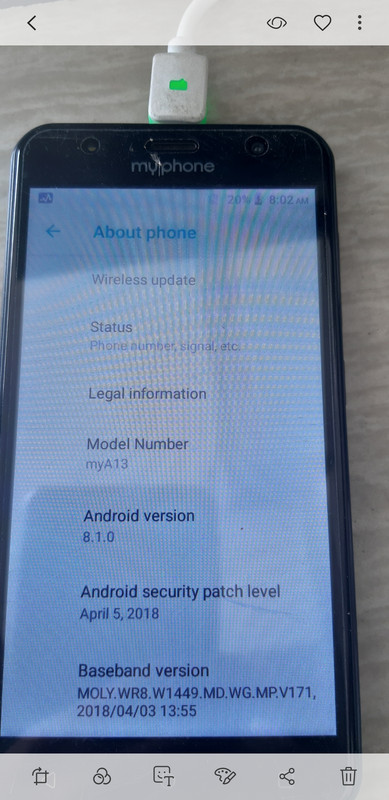

MAIN PROBLEM:
1. TO START ANDROID ENTER YOUR PASSWORD
2. Gboard GO KEEPS STOPPING

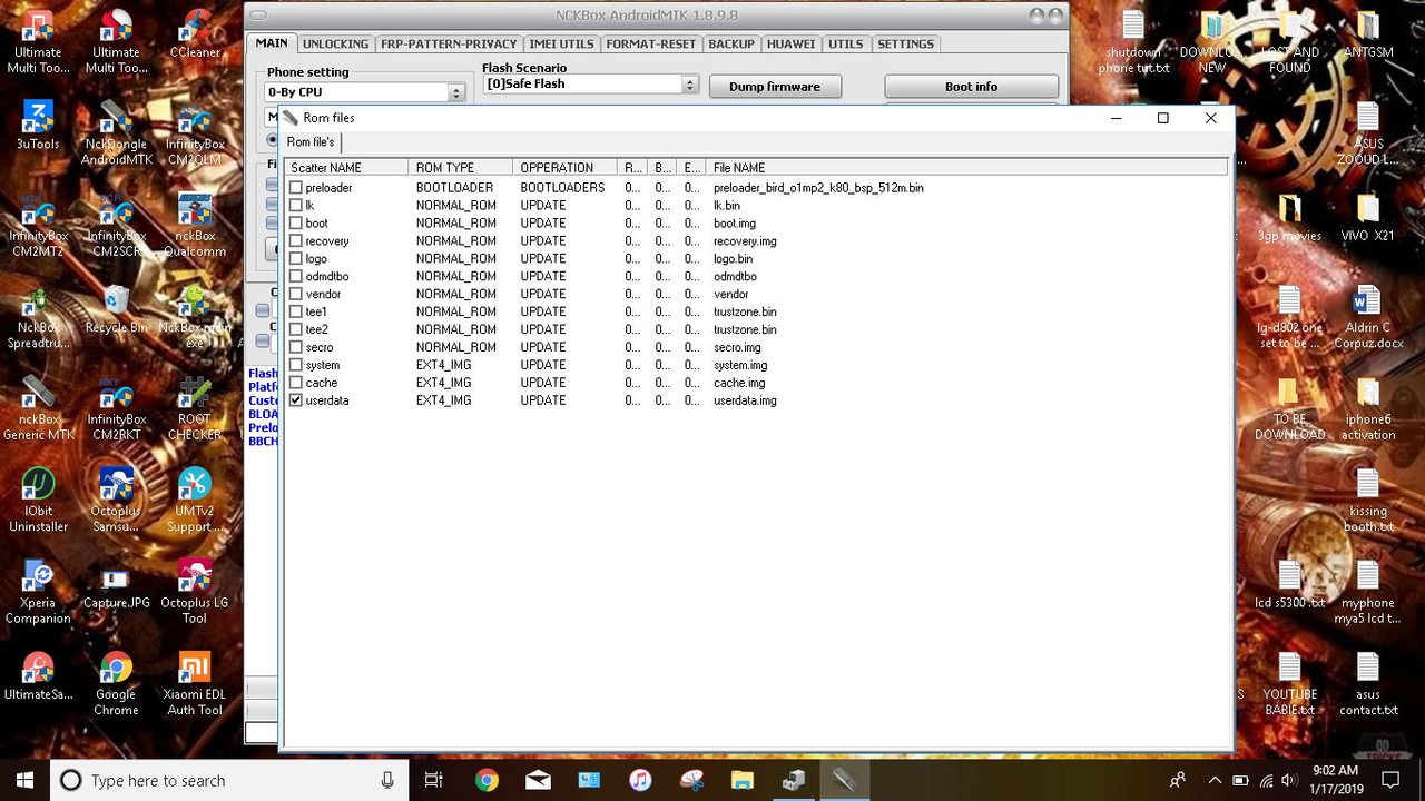

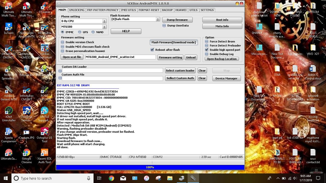

SOLUTION: NO NEED FULL FLASH
SEE IMAGES
