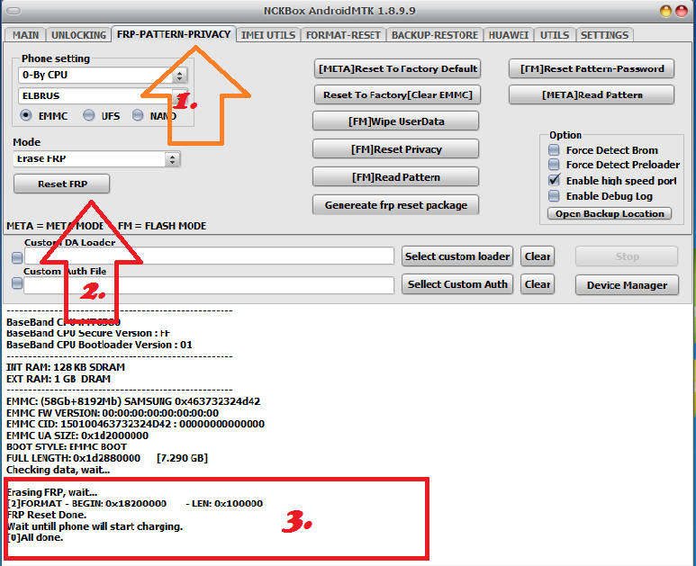

This phone have FRP partition

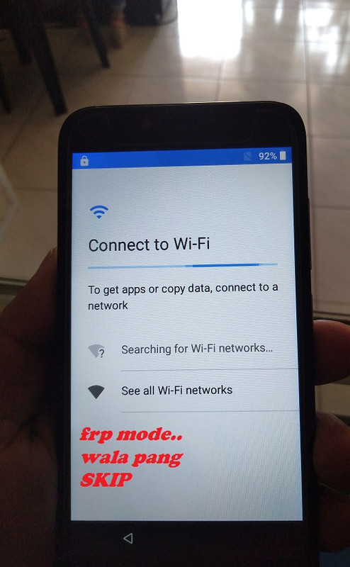

PROBLEM : FRP MODE
TOOLS/BOX : NCKBOX ANDROIDMTK TOOL
NOTE; NO need DA FILES kahit android ver. 8.1.0 na
UNIT MODE :
PROCEDURE;

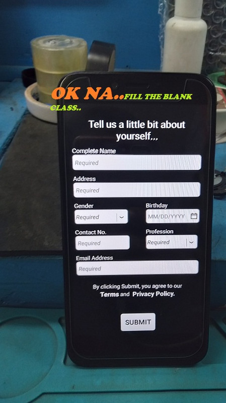

RESULT DONE:

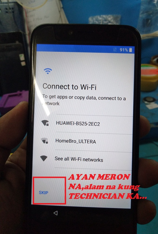

OK NA.......:):):)
