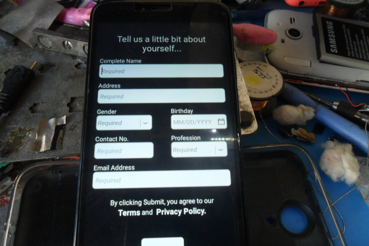

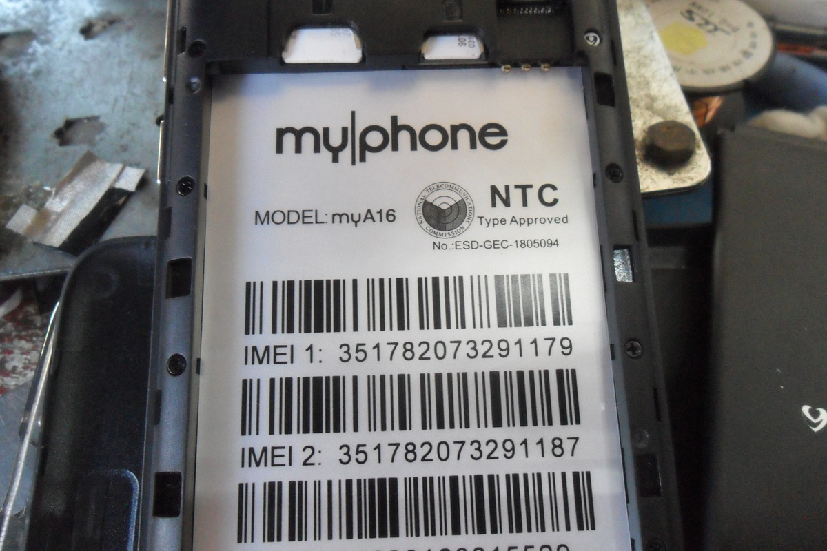

myphone MYA16 hide apps menu done
dinala ni tomer sa akin bigla nalang daw nagkaganon

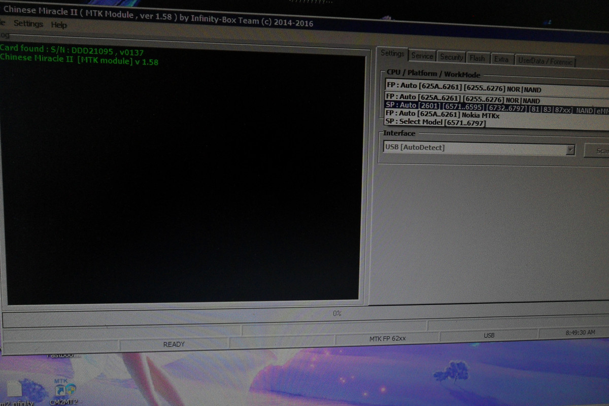

ok naman

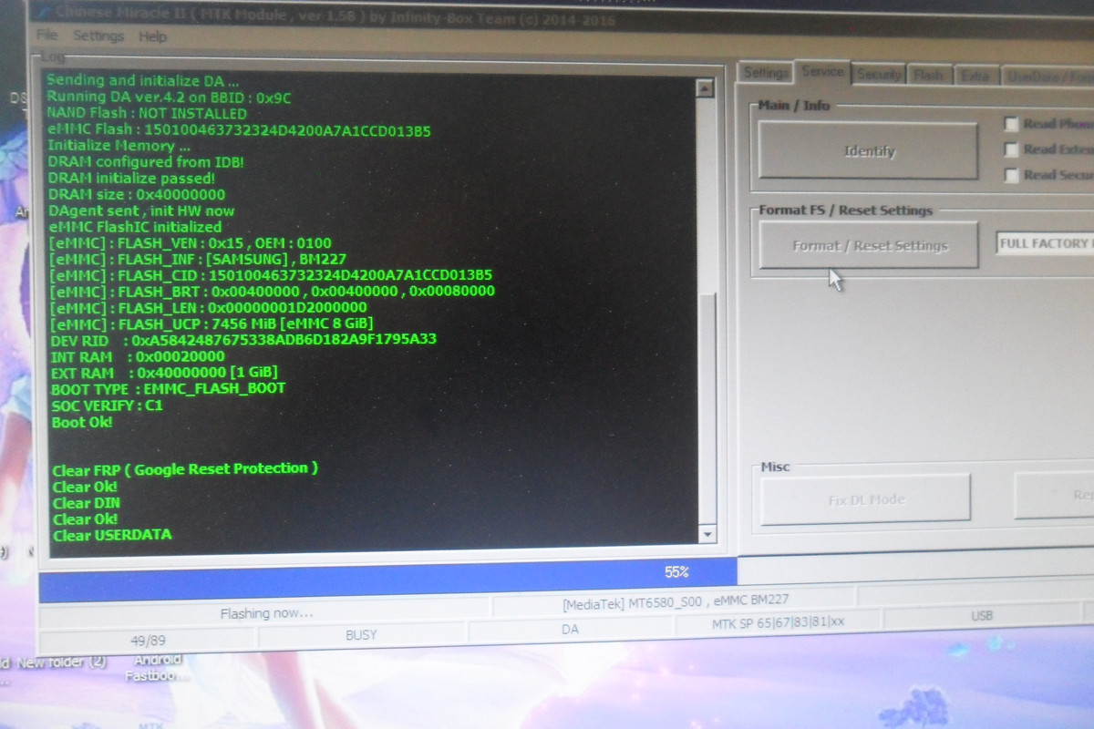

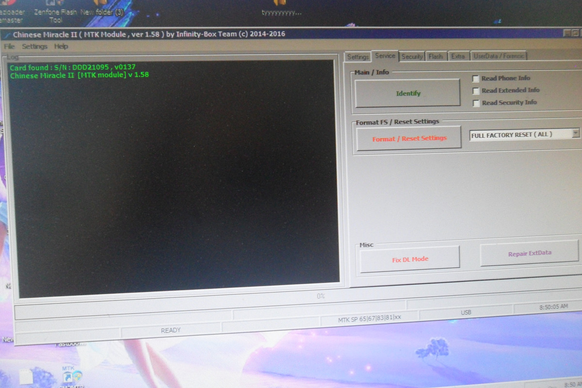

open cm2 mtk chips v1.58
click mtk chips 65xx up
click service
select full factory reset (all)

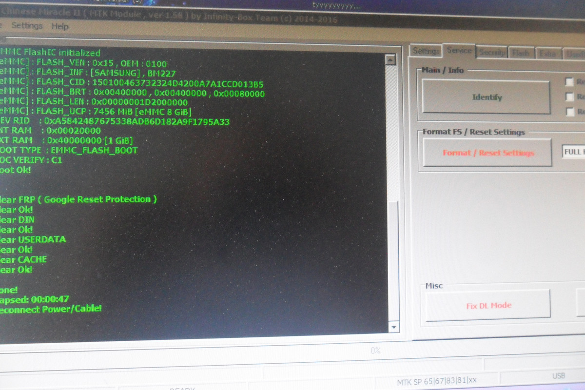

hit format
tanggal battery salpak ulit
hold volume down
salpak usb cord
wag bitiwan ang volume down kung hindi
matapos yung format
nearest ibc bank
ito tapos format
open the phone
akala ko ok na
mayroon pa
hindi pa tapos

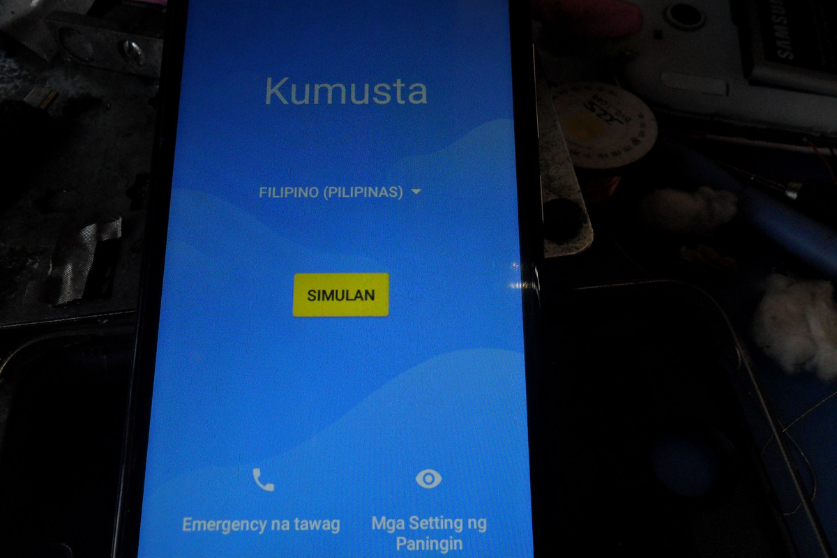

need password for android starting menu
kaya hard reset tayo
for mahiwagang kamay
alam na nyo kung paano gagawin

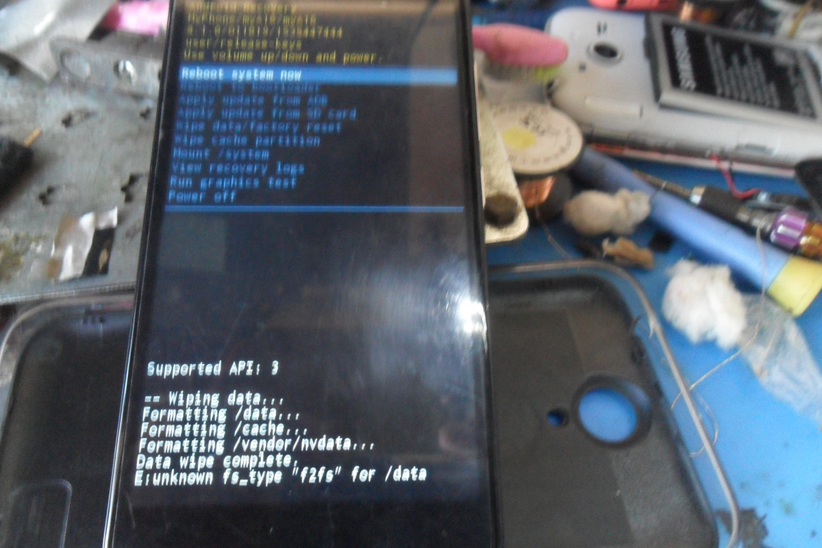

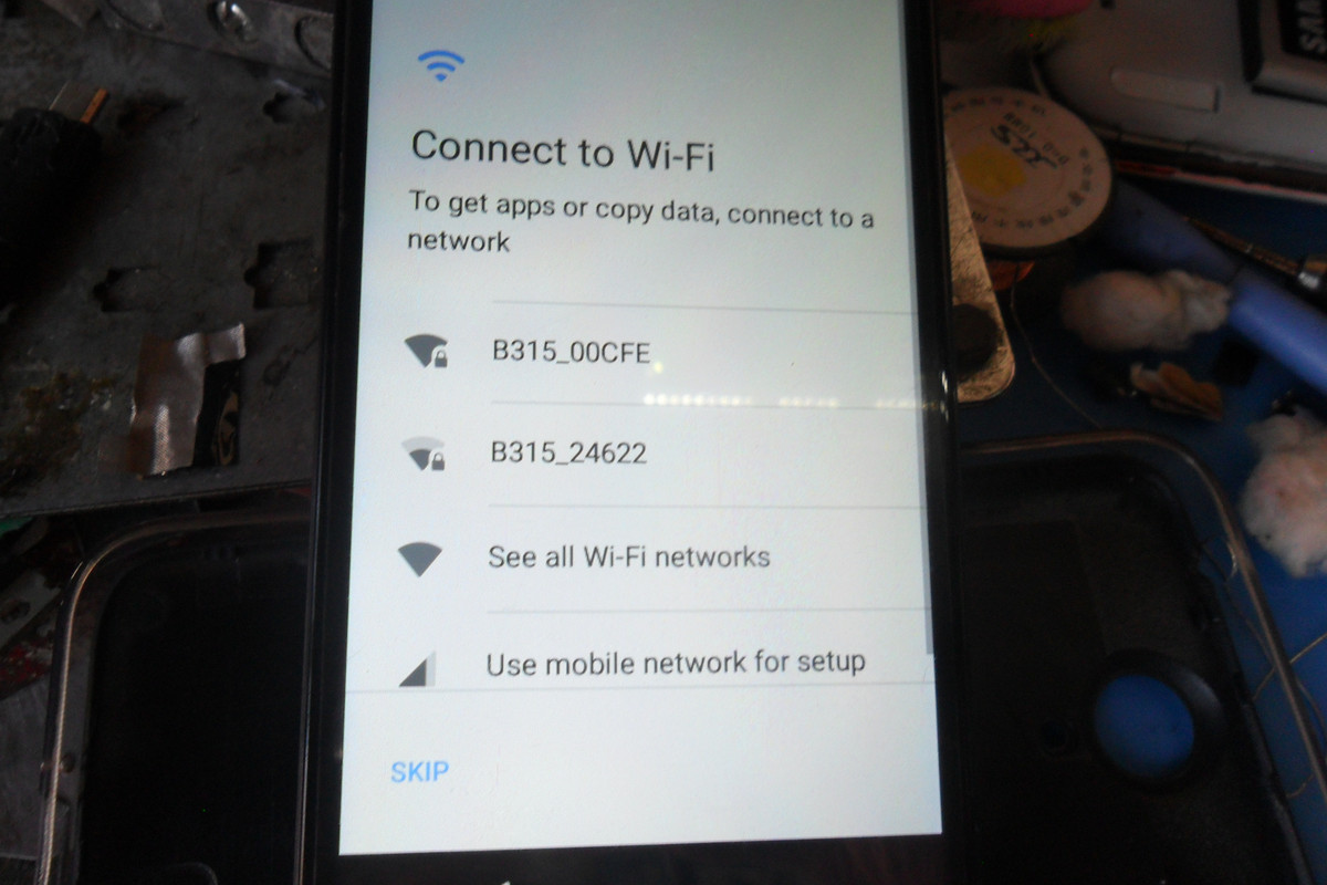

power off phone
press hold power button + volume up
to recovery mode
press volume down for ok
din lumabas na si no command
para makapasok sa recovery menu
press hold power button + click volume up
din alam na kung paano gagawin ang sumunod na prosiso
hanggang matapos ang hard reset

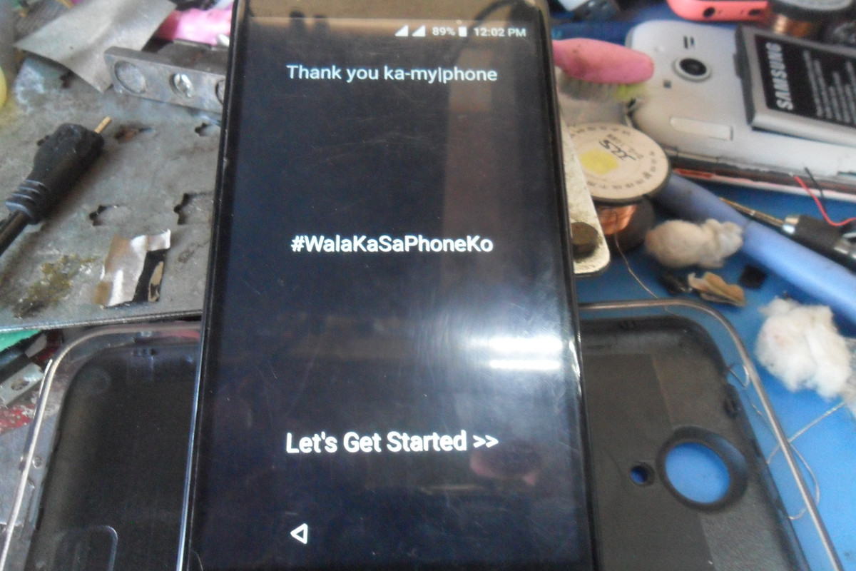

find the nearest bp gas station
need biodata

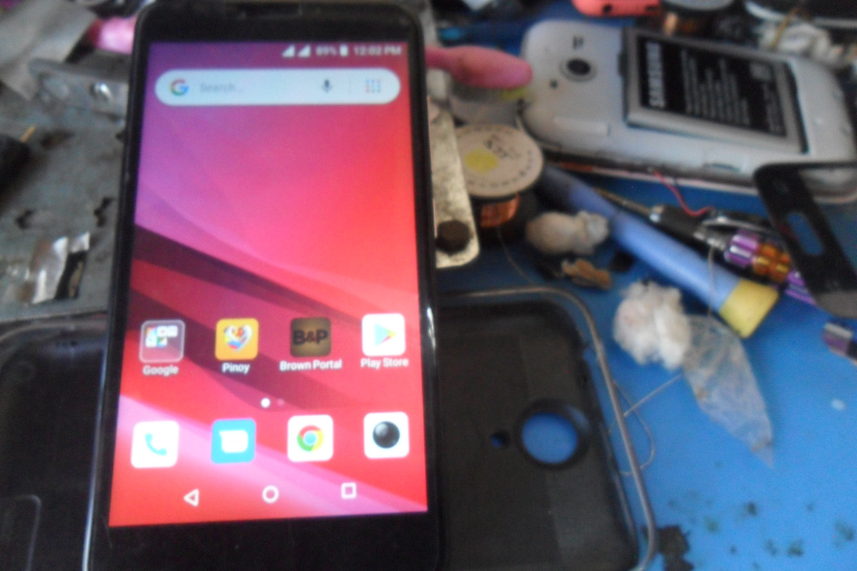

done
