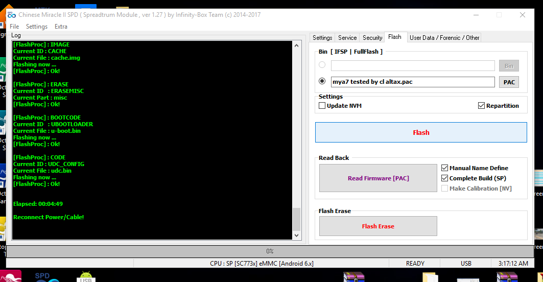

FLASH ERROR:: NOT EFFECTIVE
FLASH FDL Ready!
Boot Ok!
FlashMode Set : Ok!
PMTManager : Load 0x1C records
PMTManager : PMT Update Ok!
Flashing now
[FlashProc] : CODE
Current ID : PRODNV
Current File : prodnv.img
Flashing now ...
[FlashProc] : Error with code 0x00027E00A20000FF5D7E
Elapsed: 00:00:45
Reconnect Power/Cable!

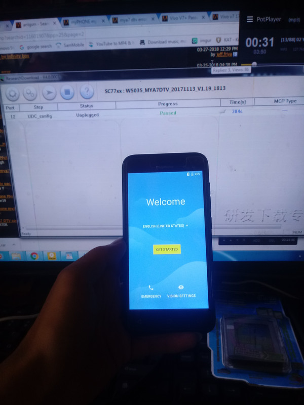

.TESTED for ME...
.sensya wlang SS nagmamadali kasi natagalana ako sa pag sunod...
Salamat dito at kay Sir JICE for the pass, nabunutan ako ng tinik.................

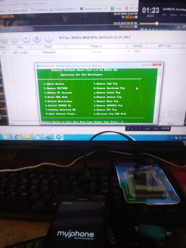

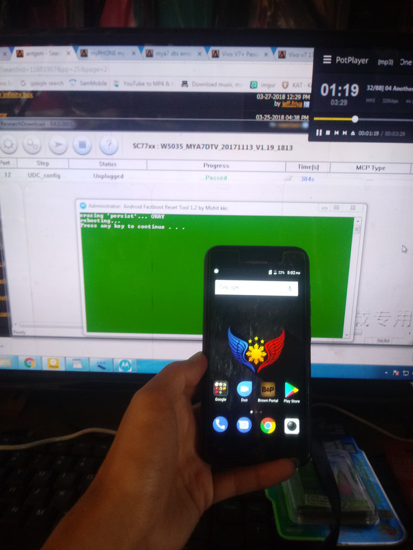

myA7 hang logo+error+dead+FRP DONE! ! !
Makunat ang Unit nato, tyaga lang. 500 petot. . .

sir salamat sa fw tested tricks step one flash RD second flash cm2 done
