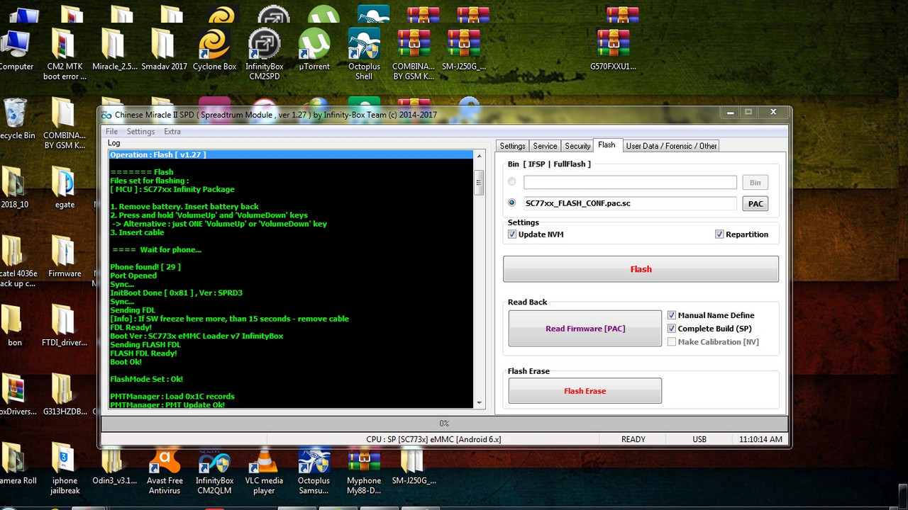

Problem... Hang on Logo
Solution:
* Open CM2 Spreadtrum
* Go to Setting set to CPU: SP (SC773x)eMMC(Android 6.x)
*Then go to Flash and Load Pac File and check update nvm para walang problema sa imei after flashing,,,
* Hold Volume Down and pindutin and Flash and hintayin matapos done.....
https://i.postimg.cc/sxNCL8xj/My7-dtv.jpg
