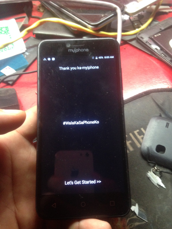

ina reset sa kapitbahay
open cm2mtk then select sp auto sa settings tab then sa service tab click mo ung full factory reset(all) down arrow then select ung frp (reset protection) then click format/reset settings then hold volume up ng phone then salpak si usb Done...

ina reset sa kapitbahayopen cm2mtk then select sp auto sa settings tab then sa service tab click mo ung full factory reset(all) down arrow then select ung frp (reset protection) then click format/reset settings then hold volume up ng phone then salpak si usb Done...
