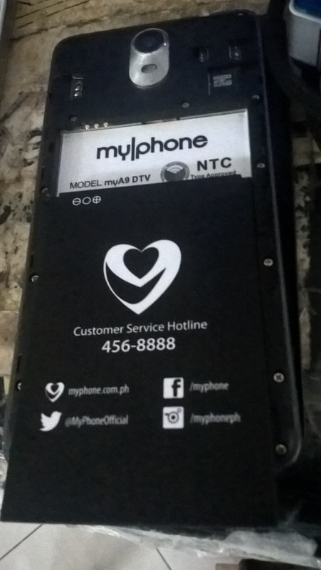

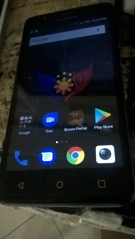

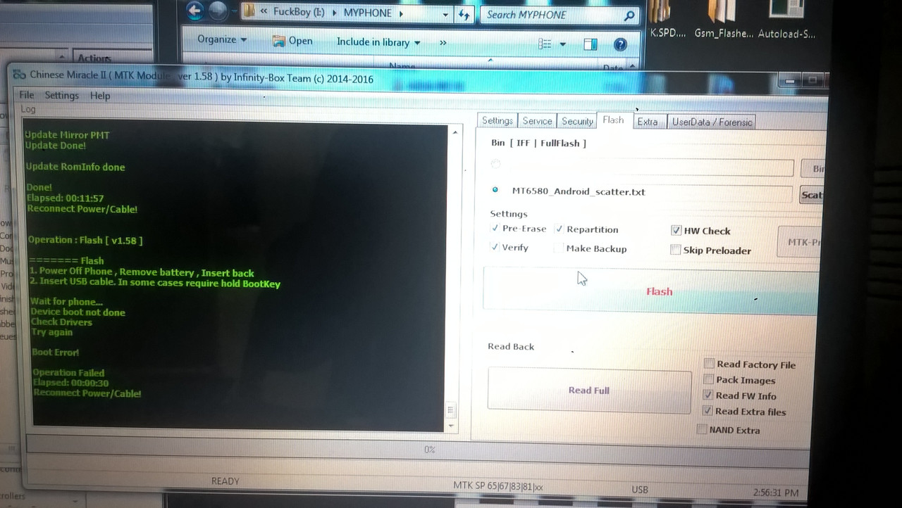

GOODDAY SHARE KO LANG GAWA KO myA9 DTV NO POWER PRO MA DETECT PA SA LAPTOP KYA GINAWA KO FLASHING VIA CM2dongle AT DOWNLOAD TESTED FIRMWARE AT DTO SA TAHANAN KO NAHANAP THANKS PLA SA ORIGINAL UPLOADER.
1.DOWNLOAD FIRMWARE here:
http://www.mediafire.com/file/5c568....mp2-V1_esky6580.we.n_P22(m8+BACK+UP+CM2).rar
2 OPEN CM2dongle (MTKmodule)
3 INSERT USB CABLE
4 HOLD BOTHKEY + -
5 WAIT MINUTES PRA SA FLASHING MATATAPOS..
DONE ..SANA MAKATULONG ..
