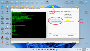

Share ko lang dala ni tumer Myt5 dtv password problem.
Remove By CM2MTK W/Back up flash file

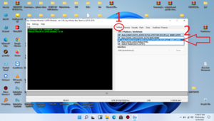

1.Open CM2MTK
2.Click: Settings tab.
3.Select: SP : Auto [2601] [6571..6595] [6732..6797] [81 | 83 | 87xx] NAND | eMMC
4.Click: Service tab.
5.Select: FULL FACTORY RESET (ALL)
6.Click: Format / Reset Settings
No boot key: Connect usb Cable and wait it done
At ito din po ung back up ko
Link: https://drive.google.com/file/d/1vqgRmSvzq2ue2NMs73BytiJ7qTI9zm6s/view?usp=drivesdk
Ito nMn po ung info ng files
Card found : S/N : 1AEDBDC8 , v0151Remove By CM2MTK W/Back up flash file
1.Open CM2MTK
