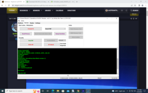

PROCEDURE
1. Open CM2SP2
2. tick Platform Setting
3. CPU [ platform ] : check: SC9832E_BASE Model [Type]: SC9823E_eMMC_1GB_RS
4. Ttick Service
5. set: Reset FRP then click Format FS
6. press volume down then connect phone to pc
wait untill done
1. Open CM2SP2
4. Ttick Service
wait untill done
