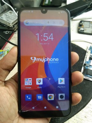

blessed day sa lahat share ko lang to myphone restart only
sabi ni tomer bigla nalang daw nag ganun sabi kong magagawa pa sabi ko try lang natin

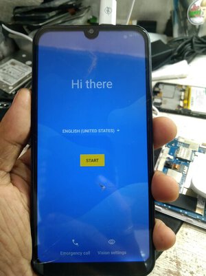

nagkasundo kami sa price sana makatulong tested yung fw na gamit ko credits sa original uploder ng fw
history restart only
solution

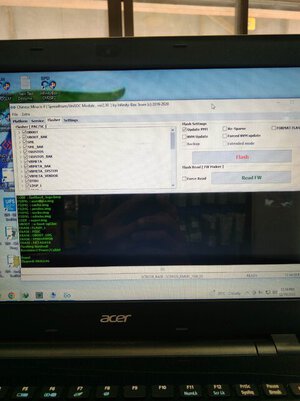

1basic moves muna kaso no lock lahat kya proceed na ko sa flashing
ito gamit ko fw
https://mega.nz/file/tdpgAAgB#5IQcQ7DZF6RnLnrIv0oeupEd5QhCn_5esp_Unav5pq0
Procedure:
1. Run CM2SP2
2. Platform tab select SC9832E
3. Flasher tab, right click then select open PAC/SC option
4. Click flash button
5. Press volume down then connect phone pag na detect na wait na lang hanggang matapos
