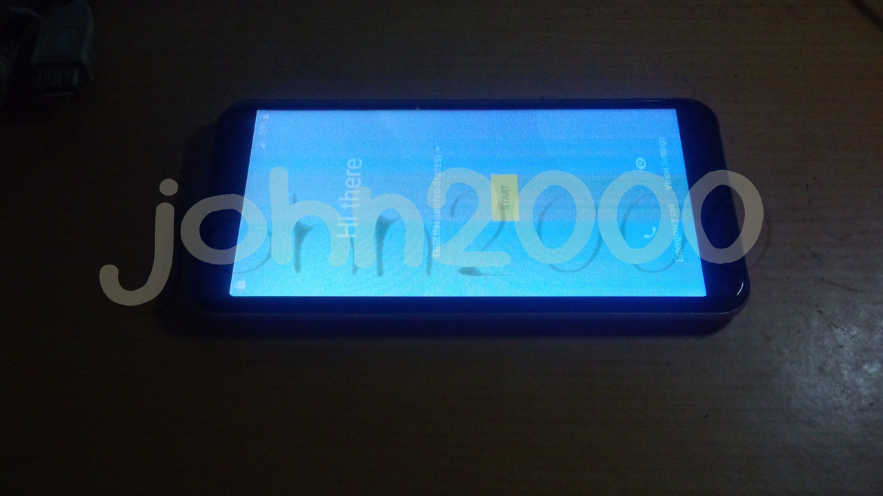

MyPhone MyX3 FRP
History :
Ni Reset
Solution :
Reset FRP

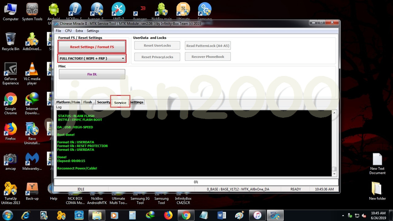

Run InfinityBox CM2MT2 GUI
Click Service Tab
Select Full Factory ( Wipe + FRP ) sa Dropdown List
note : FRP [Reset Protection] ang una kung ginawa pero naghihingi ng Pattern sa setup
Insert CA-101 Micro USB Cable
Hit Reset Settings / Format FS
Wait till format done

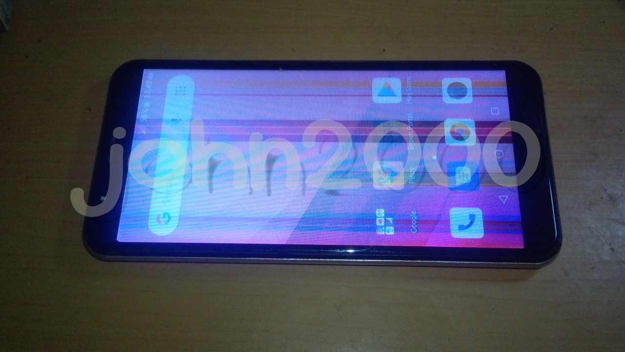

Result :
Done...
