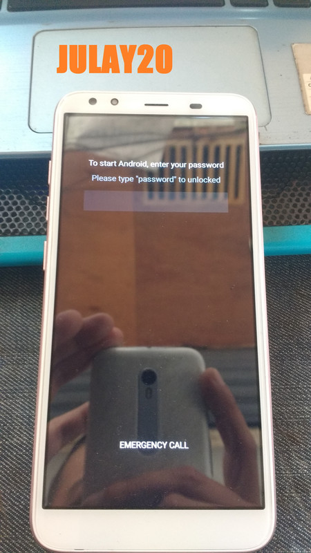

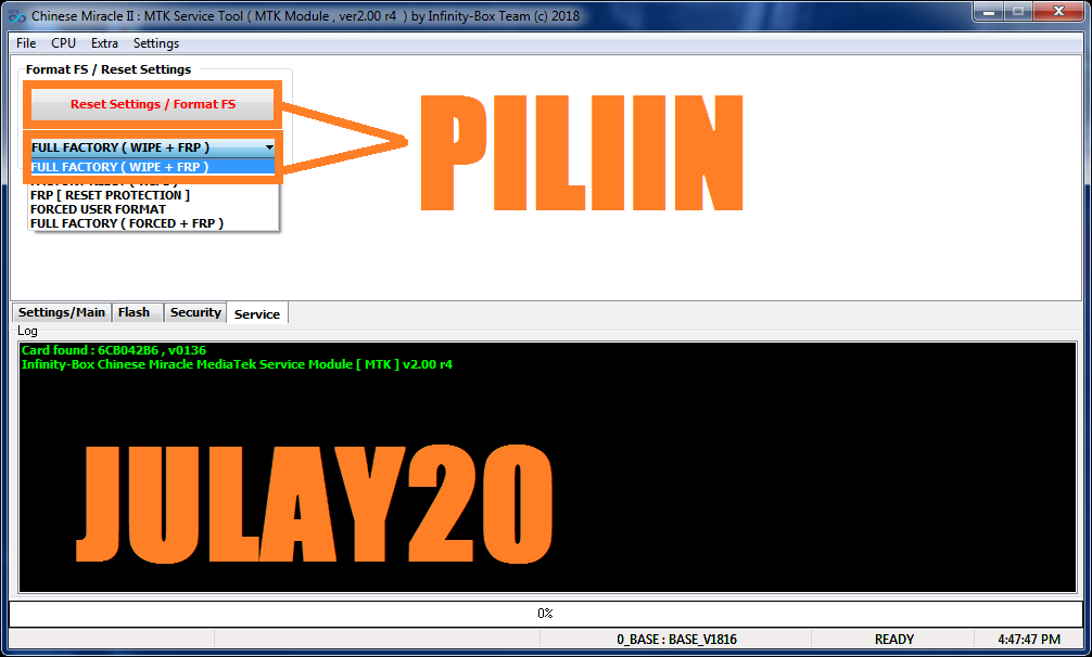

history:
nalimotan ng tumer yung password una hanap ako sa tahanan kong my naka gawa na nito my nakita ako pero file lang walang my naka gawa ng frp o google account kaya nag hanap ako sa google youtube wala akong my na kita

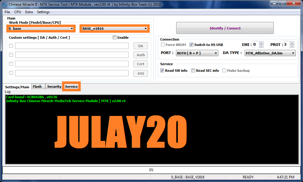

na isip ko una try ko sa CM2 MTK nag run po pero error po yung lomabas
kaya na oa isip ako tignan yung driver ng phone QLM pala try ko sana sa CM2 QLM pero na isip ko sa CM2 MTK2 kaya =)) ayun nag run ito ohh...

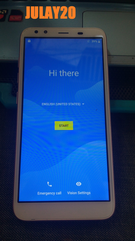

pro bago yan hard rest mona kc di ko alam anong tools gagamitin nong una gamit sa hard rest power kamay alam na yun

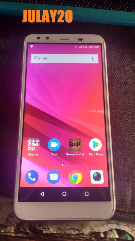

sonadan mo lang yung ss wala kang ma kikita kc na pindot ko yung X nawala yung ss ng FRP done hehehehe kaya my patonay ako na na tangal my back up tayo pero uploading anlaki ng file
DONE

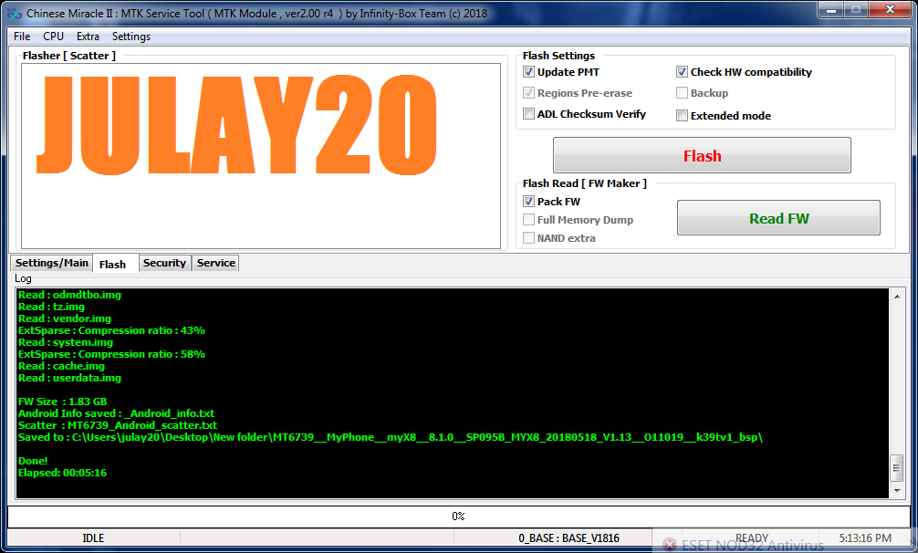

BACK UP INFO:
Code:
Card found : 6CB042B6 , v0136
Infinity-Box Chinese Miracle MediaTek Service Module [ MTK ] v2.00 r4
Operation : Read Firmware [ v2.00 r4 ]
1. Make sure device is powered off. Power off, if need. Wait 20 seconds after
2. Insert USB cable in phone
Waiting for device connection ...
PTFN : PreLoader USB VCOM (Android) (COM8)
MODE : PRELOADER PORT
PORT : 8
Waiting BOOT ack ...
PRELOADER : ACK confirmed!
BROM : Init BROM
BROM init passed!
CHIP : MT6739 , SBID : 0x8A00 , HWVR : 0xCB00 , SWVR : 0x0002
TYPE : MODERN RAPHAEL
BROM : SecLevel : 0x00000000
BROM : SecMode : PLAIN [+PRL]
BROM : PRELOADER PORT
MODE : 0_base : BASE_v1816 | Manual : Disabled
AGENT : Look for suitable BootChain in DA ...
AGENT : MTK_AllInOne_DA.bin
AGENT : Found MT6739
AGENT : MTK_DOWNLOAD_AGENT
BROM : Sending 1st DA ...
BROM : DA sent
BROM :Transfer control to DA ...
DA : AGENT started!
DA : SYNC
DA : MODE : PRELOADER
DA : EXT_RAM initialized!
DA : BOOT to 2nd DA ...
DA : 2ND stage confirmed!
DA : SYNC with DA passed!
DA : Receiving HW info
SRAM: 0x00020000 [ 128.00 KB ]
DRAM: 0x80000000 [ 2.00 GB ]
EMMC: 150100514536334D4203B441D638458F
EMMC: VEN : SAMSUNG | OEM : 01 | DEV : QE63MB
EMMC:
BOOT1 : 0x00400000 [ 4.00 MB ]
BOOT2 : 0x00400000 [ 4.00 MB ]
RPMB : 0x00400000 [ 4.00 MB ]
USER : 0x3A3E00000 [ 14.56 GB ]
CHIP : MT6739 , SBID : 0x8A00 , HWVR : 0xCB00 , SWVR : 0x0000 , EVOL : 0x0000
RNID : 5CFA84AB52ED40BB67E98C93D11344A9
DA : USB : HIGH-SPEED
Boot done!
Patch Level : O11019
Display ID : SP095B_MYX8_20180518_V1.13
Ver. CodeName : REL
Ver. Release : 8.1.0
Sec. Patch : 2018-05-05
Build Time : 1527777018
Product Model : myX8
Product Brand : MyPhone
Product Name : myX8
Product Device : myX8
Product Manfct : MyPhone
Product Info : k39tv1_bsp
Product Board : myX8
Board Platform : mt6739
MT6739__MyPhone__myX8__8.1.0__SP095B_MYX8_20180518_V1.13__O11019__k39tv1_bsp
Read : preloader.bin
Read : recovery.img
Read : proinfo.img
Read : md1rom.img
Read : md1dsp.img
Read : spmfw.img
Read : mcupmfw.img
Read : nvram.bin
Read : lk.bin
Read : loader_ext.img
Read : boot.img
Read : logo.bin
Read : odmdtbo.img
Read : tz.img
Read : vendor.img
ExtSparse : Compression ratio : 43%
Read : system.img
ExtSparse : Compression ratio : 58%
Read : cache.img
Read : userdata.img
FW Size : 1.83 GB
Android Info saved : _Android_info.txt
Scatter : MT6739_Android_scatter.txt
Saved to : C:\Users\julay20\Desktop\New folder\MT6739__MyPhone__myX8__8.1.0__SP095B_MYX8_20180518_V1.13__O11019__k39tv1_bsp\
Done!
Elapsed: 00:05:16
