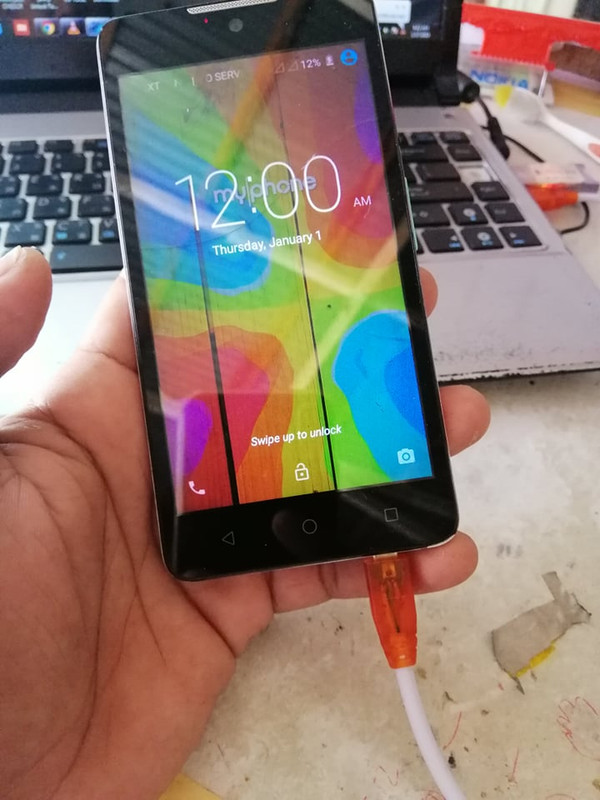

MyPhone RIO 2 FUN laging na ka andriod lang done using Cm2......
at salamat din po kay boss: HAKI sa tested fw nya at sa trhead nya sakanya po galing yung fw na ginamit ko :):):):):):)

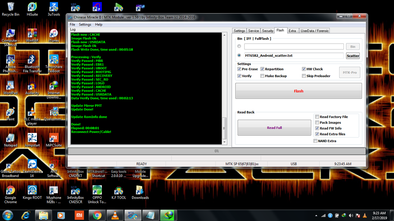

ITO PO SS: :):):):):):):):):)
Scatter Load Ok , BaseBand : MT6582 , Project : s5222 , Storage : EMMC
Files found : 11 , Set to Flash : 10
Created by Infinity-Box (c) Chinese Miracle II (c) 2016
Device Brand : MyPhone
Device Model : MyPhone_Rio_2_Fun
Device CPU : MT6582
Device IntName : MyPhone Rio 2 Fun
Device Version : 5.0
Device Compile : 5/15/2015 3:12:42 PM
Device Project : ALPS.L0.MP2.V1_TINNO6582.WT.L_P7
Device ExtInfo : MyPhone Rio 2 Fun
Ready to Flash!
Operation : Flash [ v1.58 ]
======= Flash
Wait for phone...
Phone found! [ 28 ]
Sync...
Inital Boot Ok!
BB_CPU_PID : 6582
BB_CPU_NME : [MediaTek] MT6582_S00
BB_CPU_EXT : 0xCB00 , 0x8A00 , 0x0000
Processing BROM stage
Settings for BROM configured!
SecCfgVal : 0x00000000
BromVer : 0x00FF
BLVersion : 0x0001
Processing DA stage
DA Select done, will use MTK_AllInOne_DA_v5.1624.16.07
Sending and initialize DA ...
Running DA ver.4.2 on BBID : 0x87
NAND Flash : NOT INSTALLED
eMMC Flash : 90014A48384731650507BAA1002F7235
Initialize Memory ...
DRAM already initialized by Preloader
DAgent sent , init HW now
eMMC FlashIC initialized
[eMMC] : FLASH_VEN : 0x90 , OEM : 014A
[eMMC] : FLASH_INF : [HYNIX] , e1G8
[eMMC] : FLASH_CID : 90014A48384731650507BAA1002F7235
[eMMC] : FLASH_BRT : 0x00400000 , 0x00400000 , 0x00400000
[eMMC] : FLASH_LEN : 0x00000001D2000000
[eMMC] : FLASH_UCP : 7456 MiB [eMMC 8 GiB]
DEV RID : 0xA4FA2D5AFCD78F361386588903AE9827
INT RAM : 0x00020000
EXT RAM : 0x40000000 [1 GiB]
BOOT TYPE : EMMC_FLASH_BOOT
SOC VERIFY : C1
Boot Ok!
ScatCFG : BaseBand : MT6582 , Project : s5222 , Storage : EMMC
Setting : Flash Pre-Erase (Safe) : Enabled
Setting : AFF verify : Enabled
Setting : HW verify : Enabled
BL : Check HW compatibility
BL : BBID supported by BootLoader!
BL : Check eMMC compatibility
BL : eMMC supported by BootLoader!
BL : BatteryLevel : 3508 mV
BL : [WARNING] : BatteryLevel LOW!!!
BL : Flash Pre-Erase
Total blocks to Erase : 2
Erase : 0x0000000000C00000-0x0000000000100000
Erase : 0x0000000002900000-0x00000001CEE00000
Flash Pre-Erase Done, time used : 00:00:02
SecCfg Passed , 1799
BMT remark not need. Will skip
Sending Preloader ...
Use : preloader_s5222.bin
Preloader Sent , Init passed
PartCount : 0012
Update PMT by user request
Repartition Done!
Use FLN Mode
Processing : Flash Write
Flash now : MBR
Image Flash Ok
Flash now : EBR1
Image Flash Ok
Flash now : UBOOT
Image Flash Ok
Flash now : BOOTIMG
Image Flash Ok
Flash now : RECOVERY
Image Flash Ok
Flash now : SEC_RO
Image Flash Ok
Flash now : LOGO
Image Flash Ok
Flash now : ANDROID
Image Flash Ok
Flash now : CACHE
Image Flash Ok
Flash now : USRDATA
Image Flash Ok
Flash Write Done, time used : 00:05:18
Processing : Verify
Verify Passed : MBR
Verify Passed : EBR1
Verify Passed : UBOOT
Verify Passed : BOOTIMG
Verify Passed : RECOVERY
Verify Passed : SEC_RO
Verify Passed : LOGO
Verify Passed : ANDROID
Verify Passed : CACHE
Verify Passed : USRDATA
Data Verify Done, time used : 00:02:13
Update Mirror PMT
Update Done!
Update RomInfo done
Done!
Elapsed: 00:08:01
Reconnect Power/Cable!
