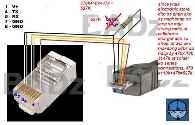

* special UART Cable (300k or 500k uartcable)

* From extracted folder run ttermpro.exe there select serial port nd change the serial port to z3x serial
port
*After Select The Serial Port Press Ok Button den Go To Setup Click Serial Port Option
Select Baud Rate 115200 Then Press Ok Button
* Now insert the created boot card to the mobile
* Connect the Uart cable via z3x box
* Now Insert the battery nd wait for 5min if the procces didnt start discnnt the mobile close ttermpro agin try it.
