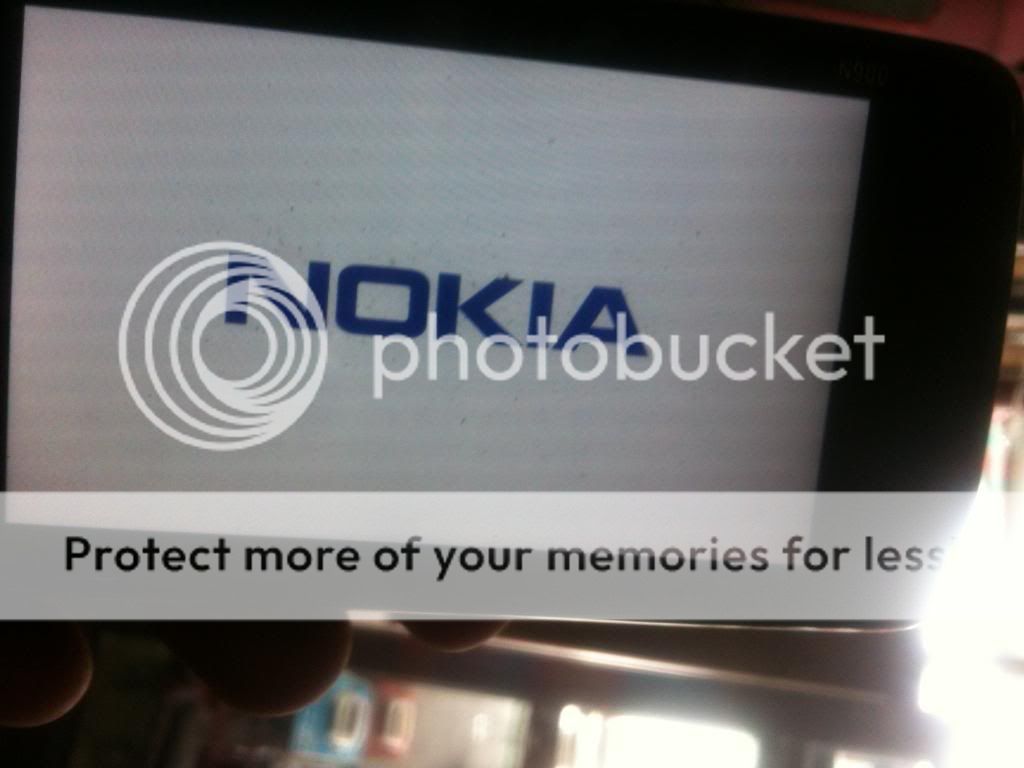

RX-51 NOKIA N900 NOKIA LOGO THEN RESTART
GANITO LANG SIYA TAPOS MAYA KONTI MAMATAY RESTART AGAIN

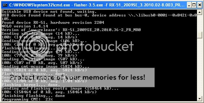

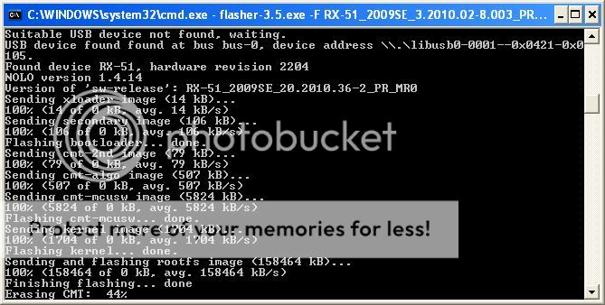

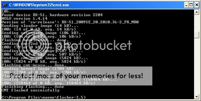

FIRMWARE AT FLASHER:
CLICK ME...N900 Flasher Tool
PROCEDURE:
FOR XP>START>RUN>THEN type CMD hit enter
I PASTE PO ITO..
PROCEDURE:
I PASTE PO ITO..
PAGKATAPOS ITO NAMAN..cd C:\Program Files\maemo\flasher-3.5
HIT ENTERflasher-3.5.exe -F RX-51_2009SE_3.2010.02-8.003_PR_COMBINED_003_ARM.bin -f -R
