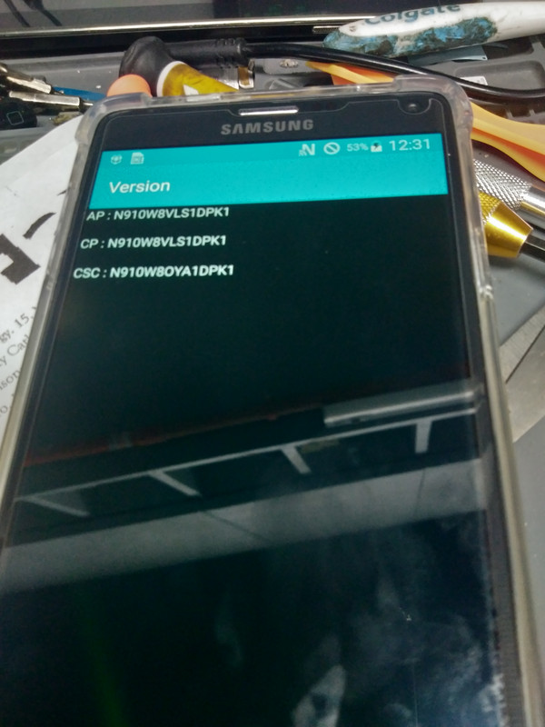

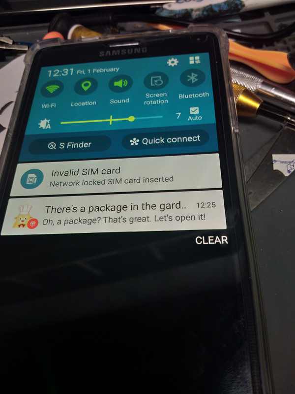

need to unlock to used any sim

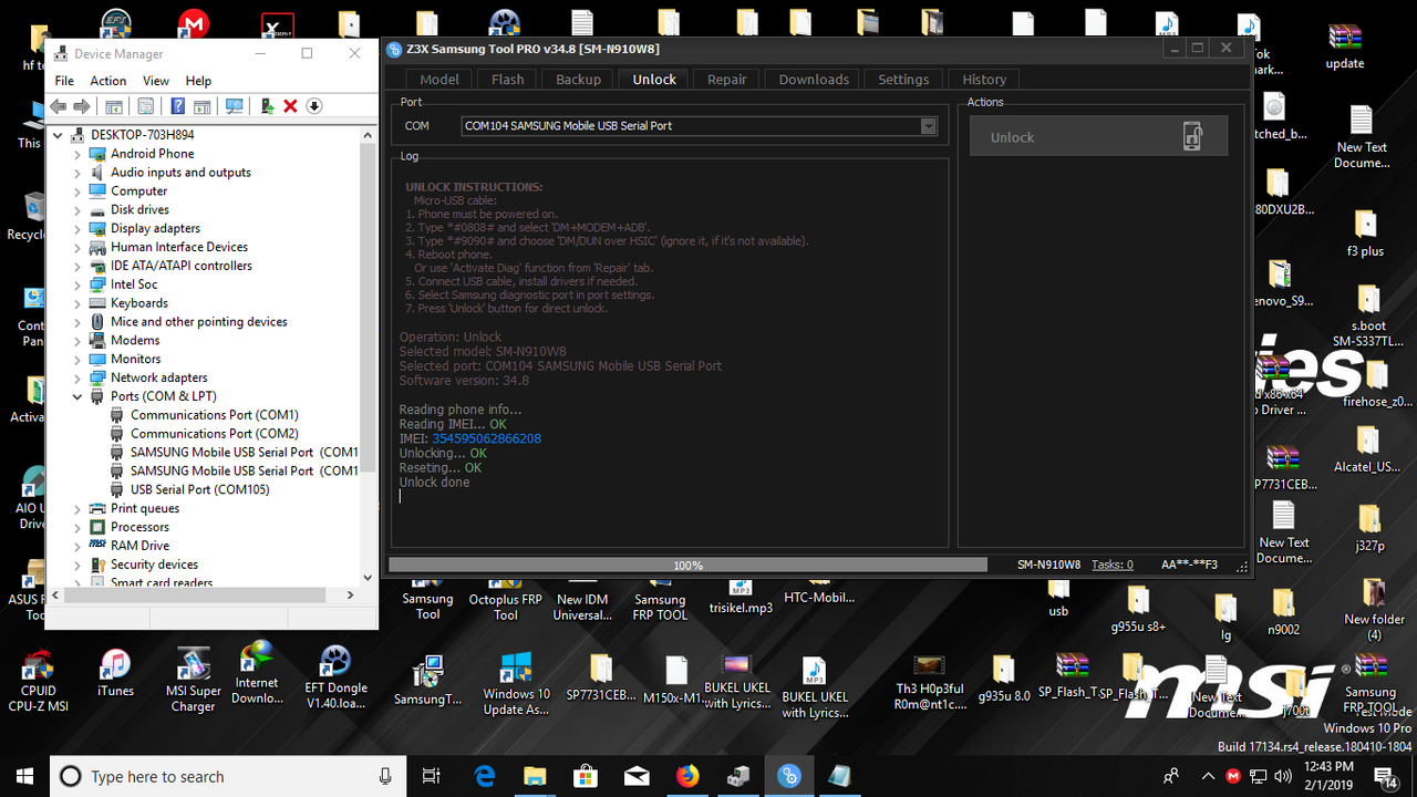

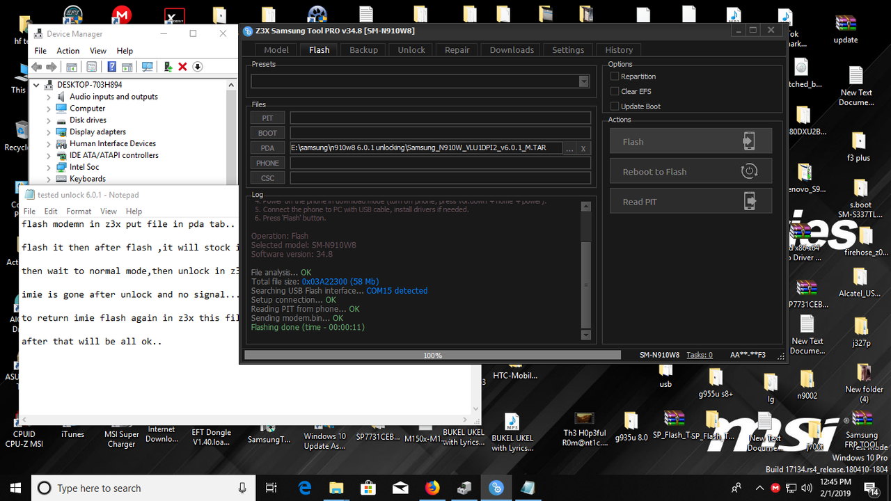

let start by downloading the file used to unlock
then flash in odin or z3x ...
iprefered z3x to flash the file...

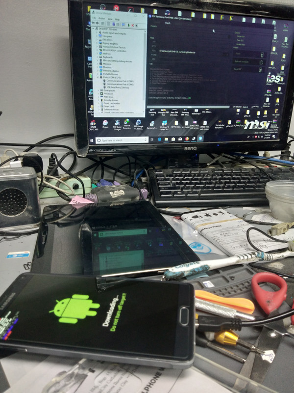

procedure for flashing
flash mo lang yun modemn na nasa rar...(extract nio muna)
pagtapos ma flash stock lang sya downloading mode gaya ng nasa screenshoot..
dont panic...hehehe...
reboot mo lang by pressing vol up,down home and power key..
wait mag reboot at mag normal sa menu..

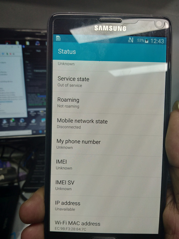

check mo imie nia unknown yan
kc nag downgrade tayu ng modemn

pero bagu natin ibalik unlock muna natin
so solve na unlock natin...na walang error 2.

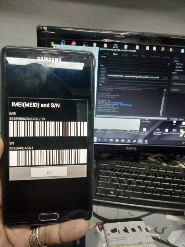

proced tayu sa pagbalik ng imie
flash natin ulit yun modemn pero etong file naman na to ang ilalagay natin
Samsung_N910W_VLU1DPI2_v6.0.1_M
nasa rar na yan...

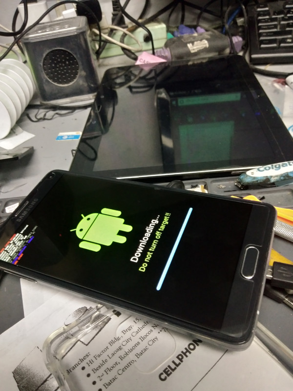

syempre ilagay nio sa download mode
at pagkatapos ng flashing i reboot nio lang kung stock ulit sa download mode...using

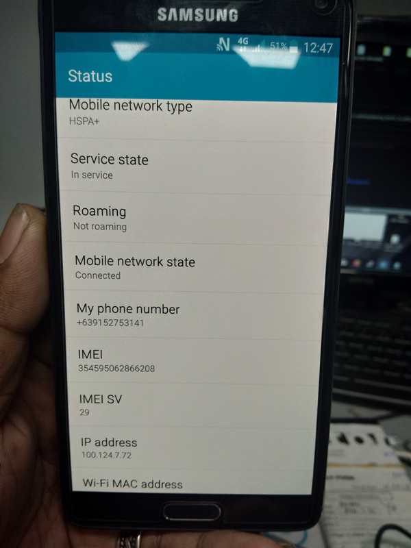

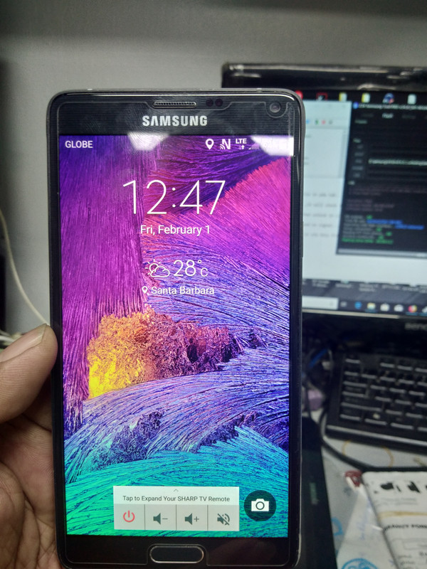

pagkatapos maiflash yun stock modemn eto na sya
may signal na sya

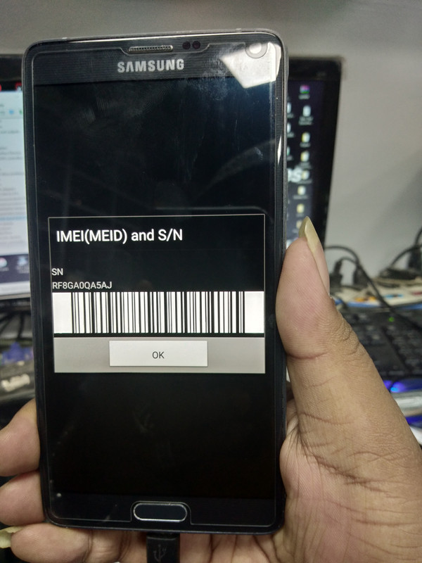

eh panu yun imie??
online photo upload
ayan buo narin...
