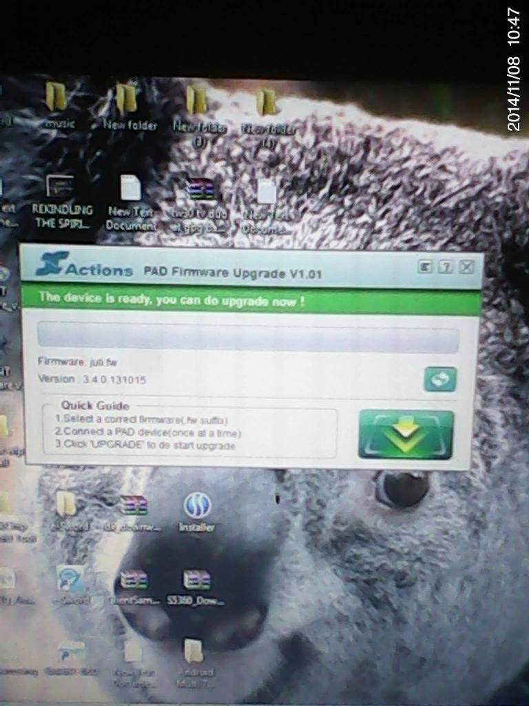

mga kaAnts baka po may firmware kayo ng Gx Pad 300D hang sa logo,history bigla lang daw,
CPU type: ATM7021A
board id: M2102 v1.2

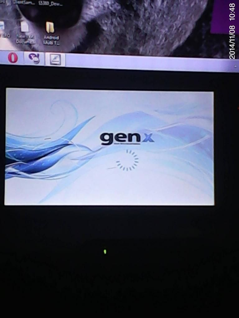

Unit Done
Hang in Logo

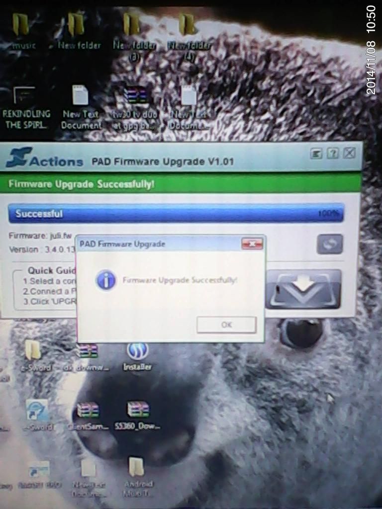

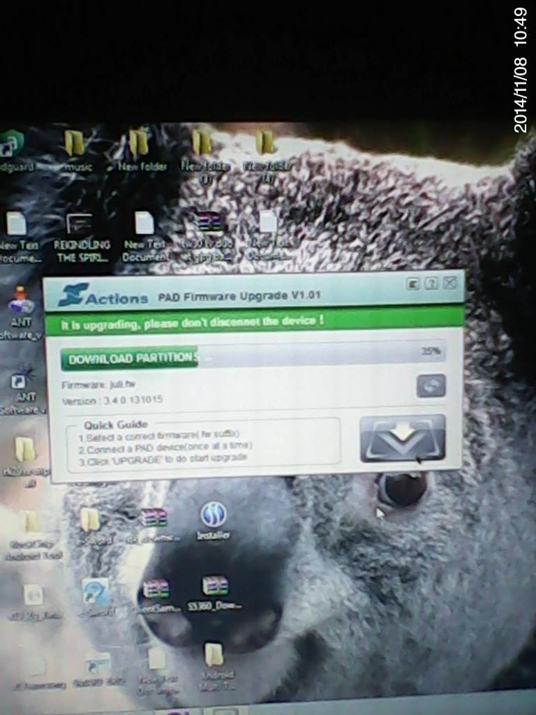

Procedure;
Open Pad Firmware Upgrade
load Firware
insert usb cable in tablet
wait till software detected the device
then thick upgrade button
Screenshoots:

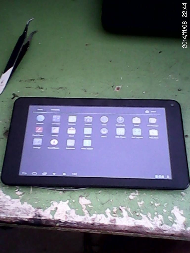

done upgrade

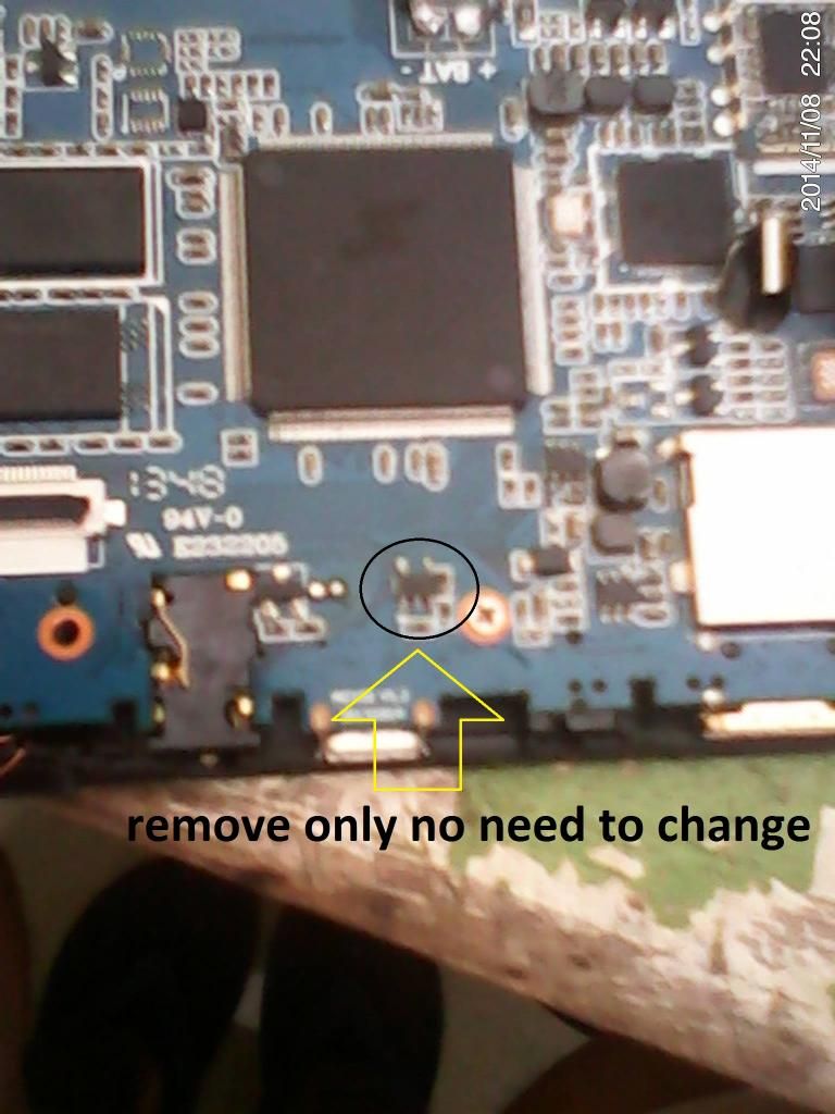

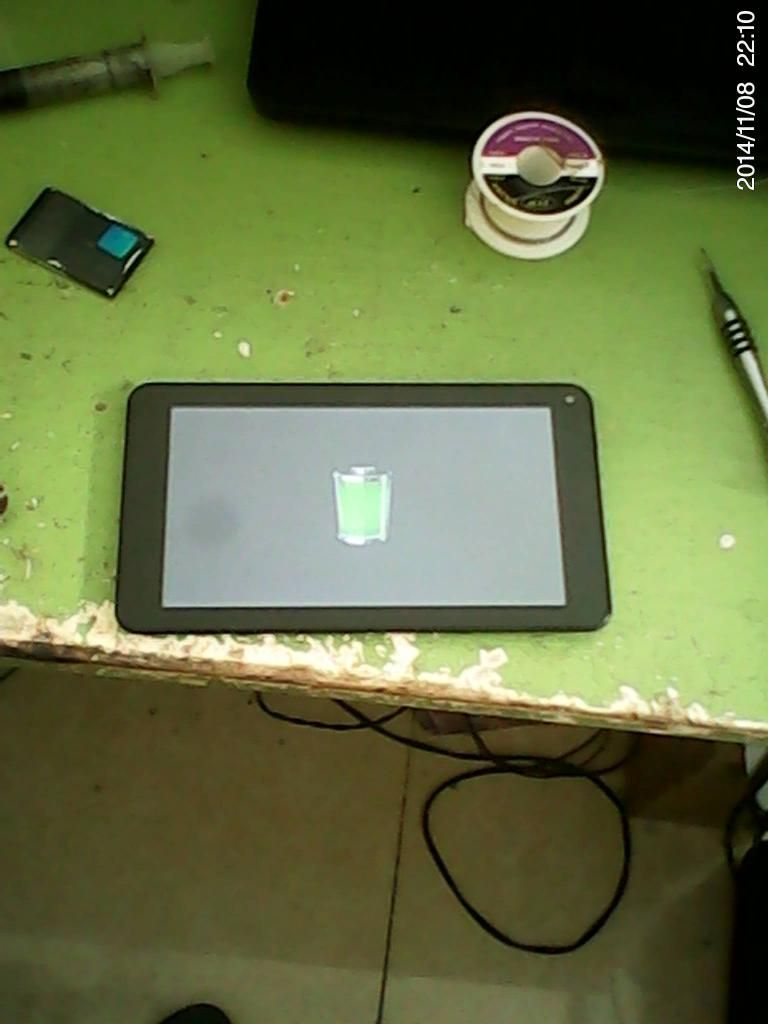

Kala ko tapos na problem ko meron pa palang sira "AUTO CHARGING" kala pala hirap iopen unit
ito po ginawa ko for auto charging" only remove 5 legs ic seen in the picture"

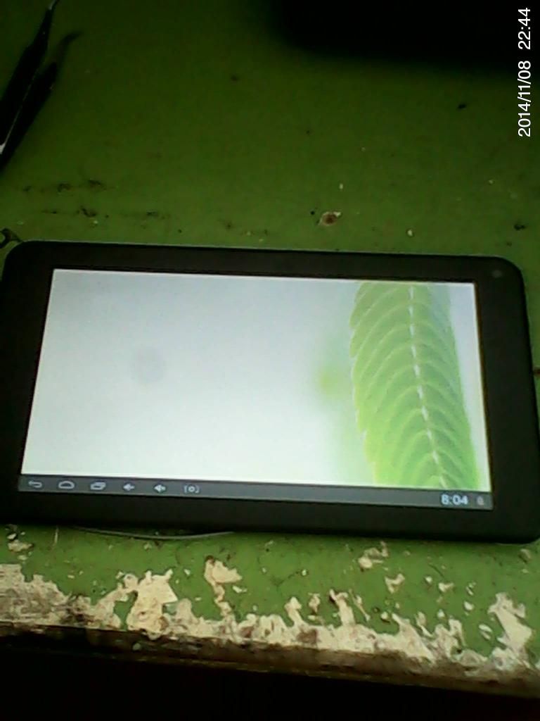

finish product
FIRMWARE: http://pan.baidu.com/s/17XHh1
NOTE: Working po lahat sa kin, maliban sa camera nya,di po ako sure kasi baka may tama din ang cam nito,try nyo na lang, at sabihin na rin sa TUMER yong possibility
sana makatulong
