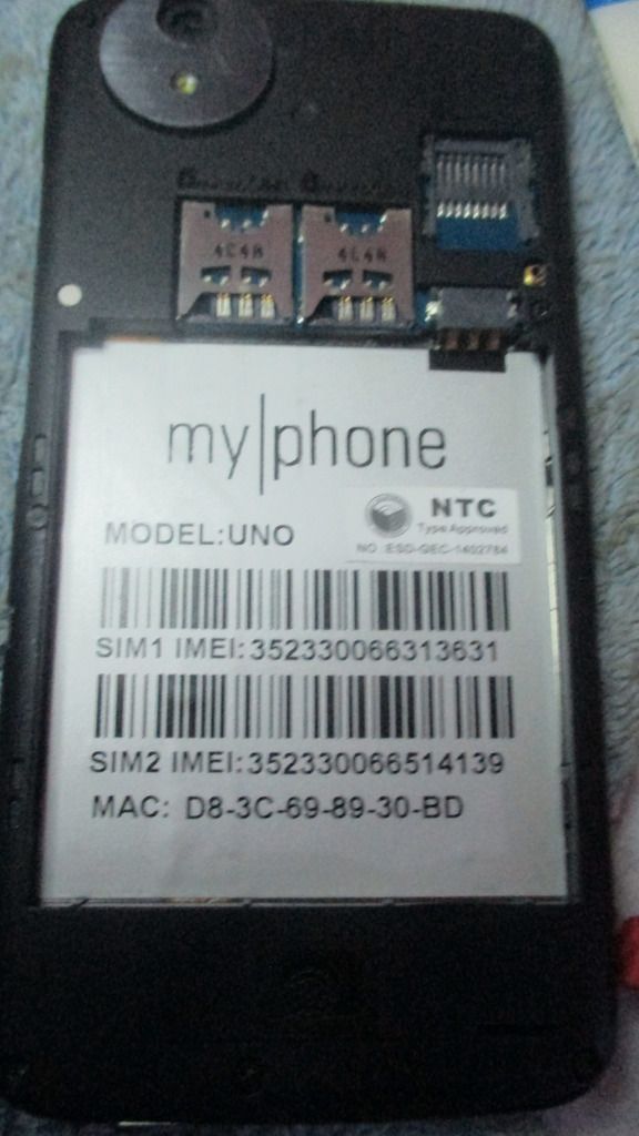

need help na dead po s flashing myphone uno

ang issue unfortunately tapos hanggang naging hang logo n daw ngaun...
need help po mga boss try ko mag hard reset no locky nag failed sya.. try ko s cm2 format failed din try ko iback up kso failed p rin...
my nakita ako d2 s forum n scatter file ng myphone uno try ko s cm2 failed din...

kaya gumamit ako ng sp tools
ok s flashing pro try ko on ung phone.. ayaw n mag open n dead sya pro ok naman s flashing s sp tools..
need help boss bka my back up kyo jan..
