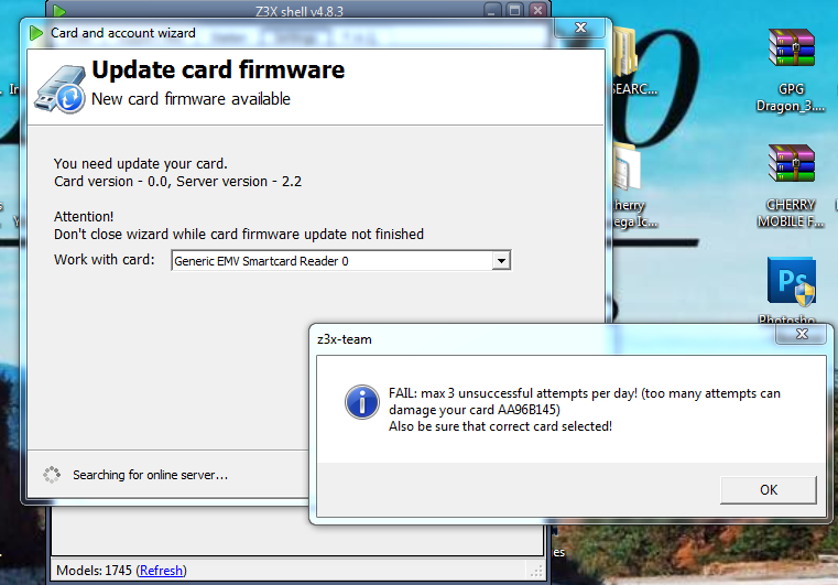

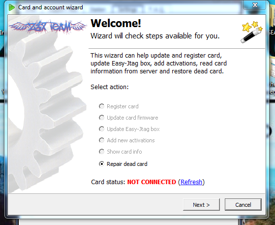

Need help z3x card notconnected

nainstall mu ba yun "usb token"???
kahit anu card driver gagana sa z3x pero pag hindi mo nainstall usb token device di madedetect smartcard
nag kaganito na din z3x ko...ginawa ko..format pc..then install ng bago..una kong install yung z3x then ininstall kuna ibang box ko..
hindi kaya nasira ang card mga boss kasi nagupdate kanina pero ndi tumuloy huminto
disable digital signature mo muna bago ka mag install ng drivers, re install mo ulit try mo.
boss last na talga... restart pc ... then press F8 F8 F8.... tapos enter Disable Driver Signature Enforcement. then reinstall smart card and use token palitan mo din wire mo o kya lagyan mo ng lacquer thinner ung toothbrush tapos linisin mo ung saksakan.
baka madami na conflict drivers...tama mga advice nila sir...format pc last option at una mo install z3x..pag all solutions fail...contact mo reseller mo to check your z3x box and smart card...all the luck idol
smart card yan lodi ano ang gamit mong os kung 64bit ka mag down ka ng os like windows 7 32bit smart card easy to install
