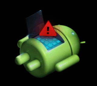

Solution:
1. power off the Tablet Next700H
2. hold press the volume +/up
3. press hold the power button in 2 seconds and release as soon as possible
4. do not release your the volume +/up button till nextbook logo appear
5. and android logo with exclamation logo will shown up
6. release volume+/up
7. while android logo with red triangle mark, press hold the power button first follow by volume up within 1 to 2 seconds.
8. voila! recovery menu shown....
thanks boss dun lang pala, may tangap ako ngayun lang ng ganitong unit salamat boss nadali ko din hehehehe
nice sharing boss ..dagdag kaalaman nanaman po ito .............................
Very useful nitong thread na ito di ko makuha kuha kanina pero nung binasa ko ng maigi tung thread ni boss KABOOM swak na swak..
salamat sa share boss tamang tama meron sakin dito ngayon same unit....
